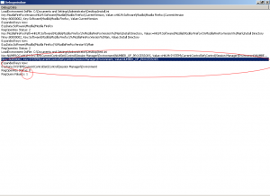

Did you load your test.ini for example?
May I get access to your system with "Windows Remote Desktop"? I can't imagine why this could happen. Are there 2 debug windows opened or did you start wihu twice?
It should show something like this:

And now, there weren't two WIHU, just two screencaptures. :)
Took the first one right when started, and then again after.
Yes i loaded test.ini.
used
wihu.exe /SkipSettigns /SkipRestart /ini-test.ini
should be
wihu.exe /SkipSettigns /verbose /SkipRestart /ini=test.ini
To test it. And if /SkipSettigns is used, I found out that environment isn't loaded.
(because settings is skiped ... but I changed this because it is confusing)
Please just redownload this exe and test it again ... don't forget /verbose switch.

i used /verbose switch before, forgot to type it....
it now works properly, with using /SkipSettings....i guess you didn't use that switch your tests while I did in mine :)

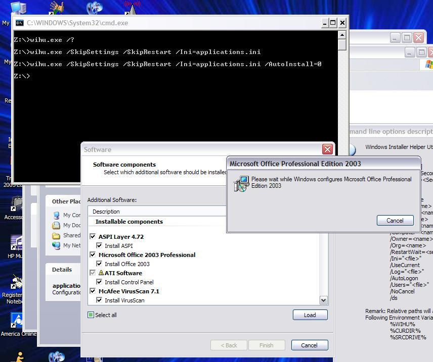

Hmmm....
Shouldn't this screen go to the progress bar thing?
I don't think it did....
If it's not meant to, perhaps a feature to see what it's doing? (still using that test version you had me use too) The feature being, in a normal Windows Installer install, it tells you the component being installed, so perhaps the description.x line to e displayed with the progress bar going across?
mmkay...never mind about the feature request :) I believe it's a bug again.
When I remove the /AutoInstall=0 switch it works fine, so does /AutoInstall=1.
Also, what is...
"Terminated error code 7. The storage blocks were destroyed"?
Yes it's a bug ... I think I should rename it back to beta 2 ... It's fixed now.
(Btw. don't know why this din't work ... according to Windows API it should work as it was ... but as always documentation arent always perfect :) )

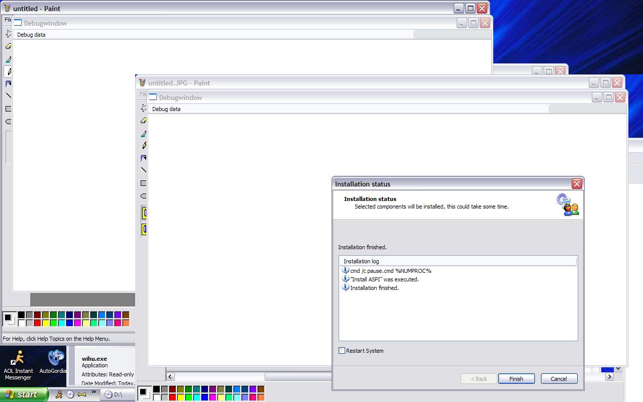

Also, when I added it to my Unattend Install, I had a WIHU instance run for my hotfixes (guess why I made that INI file :) ) but at the end it stayed at the Finish screen. When I boot up my laptop with the test install going, I'll take the VMware screenshot and show you.
I think I know what you mean ... it should be already fixed. (Some day I'll remove Autoinstall and SkipXxx things if there are so many bugs inside. :) )

mmkay, bug 4 gone (the progress bar thing) but bug 5 remains.....and I assume user error before program error :)
Bug 5 being that it doesn't get past the Finish screen.
"..\Unattend\wihu.exe /SkipSettings /AutoInstall=1 /SkipRestart /Ini=hotfixes.ini /Log=%systemdrive%\wihu-hotfixes.log"
