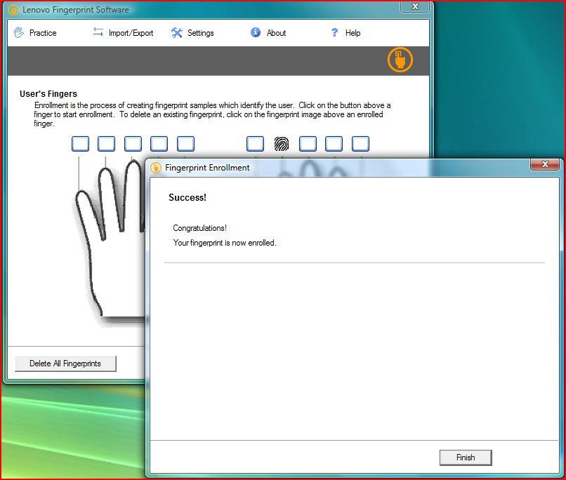

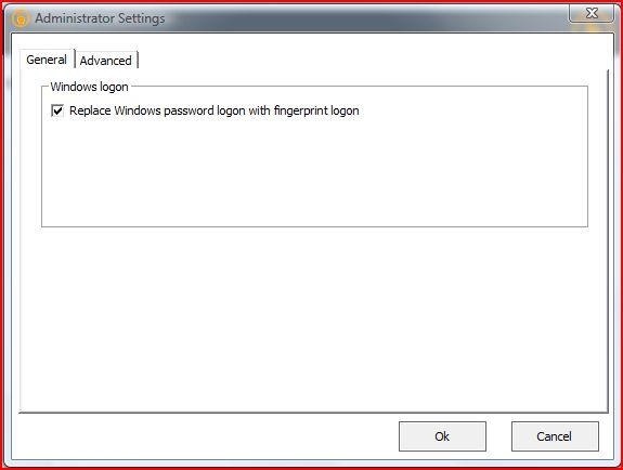

there's a ton of available drivers online for it. They do work (in the sense that the driver does detect the sensor and shows up as installed in device manager), but I cannot find a working software for it. I managed to install Lenovo Fingerprint software, which actually half-works. I can successfully enroll my fingerprint (as shown on the first image), and even enable fingerprint logon instead of Windows one (as shown on the second image), but that's about it. Nothing shows up on the logon screen, and simply swiping a finger through the sensor doesn't to anything. I also tried ThinkVantage software, but this one doesn't even recognize my Fingerprint sensor hardware and refuses to install it's own driver for it.
