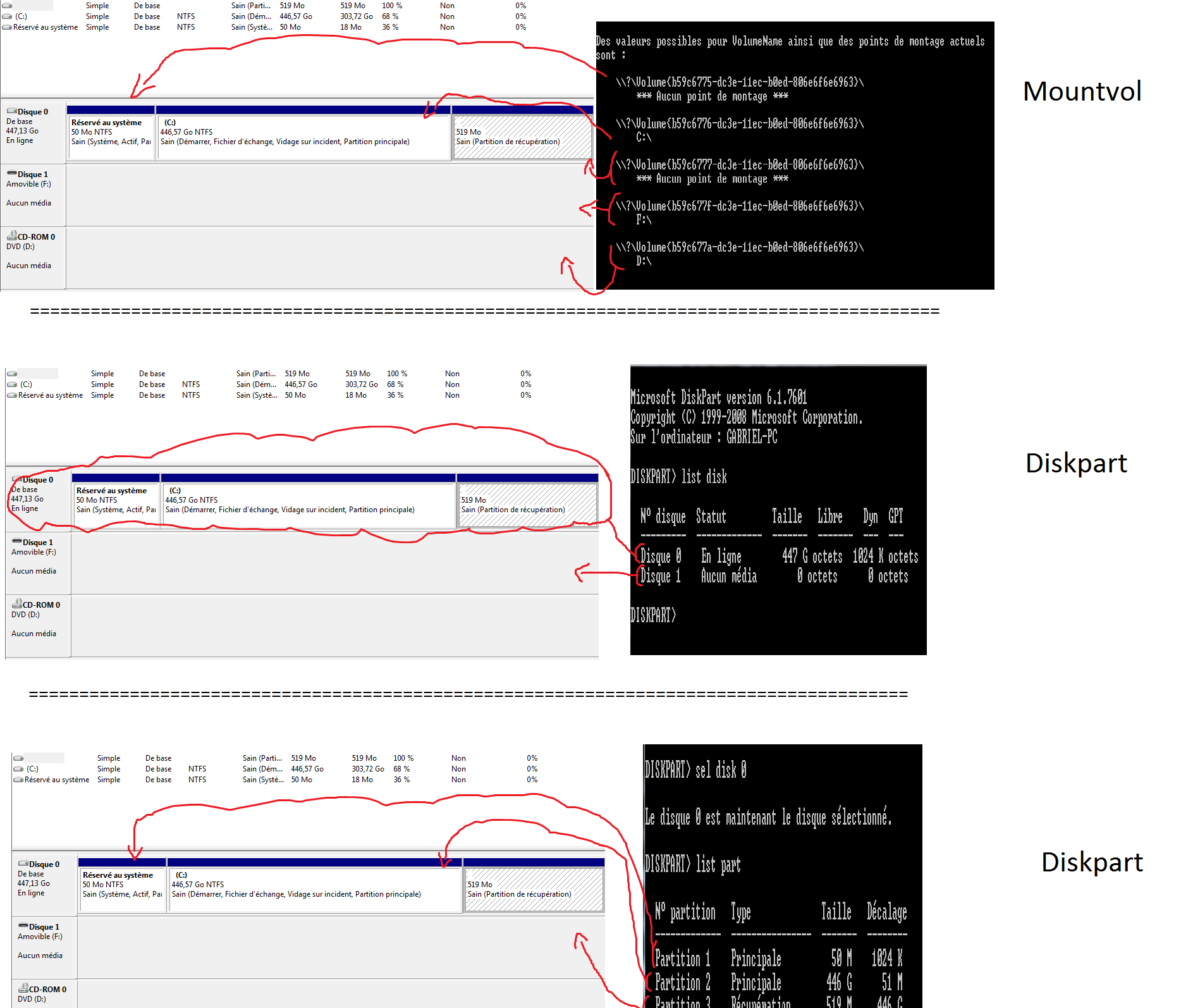

NormanCyprien Posted February 25, 2023 Author Posted February 25, 2023 Thanks for the reply. I checked disk manager but my external HDD doesn't appears (since it is not connected to my computer). When I check mountvol, I see 5 partitions: my system partition, my DVD drive, my SD card reader and 2 hidden partition (the first allows my computer to boot and the second is a re-install partition) so no traces onece again of my external HDD. However, something is off, ALL my volumes have got the same UNC name. I also checked diskpart but this time, everything looks OK. I've got 2 drives (my internal SSD and my SD card reader) and the first drive contains my system partition and the two other partitions I've already talked about. This "ghost" partition only appears on the disk defrag utility. It is absent of every other place in the system. Any ideas about how to remove it ?

NormanCyprien Posted March 4, 2023 Author Posted March 4, 2023 3 hours ago, jaclaz said: I am not sure I understand what you mean by "UNC names"? Mountvol shows GUIDs, diskpart (AFAICR) shows neither UNC nor GUID. Well, I must be wrong. When I type "mountvol", I've 5 partitions showing under names like \\?\Volume{XXXXXX-XXXX-XXXX-XXXX-XXXXXXXXXXXX}\ and under this, I've got their names with letter (C:\ - D:\ - F:\ ...). I thought that this long chain of characters was the UNC name of a drive. 3 hours ago, NormanCyprien said: (according to the UNC names that I was able to find in "diskpart" and "mountvol" What I mean here is that using "diskpart" "mountvol" and the "drive manager", I managed to link and confirm that this chain of characters was this partition and this other one this other partition etc... for all my partitions and drives. And as I already saied, no traces of any "ghost" partition in any of thoses programs and it is neither in the folder of the registry that "MikhoulLhaboul" mentioned.
NormanCyprien Posted March 4, 2023 Author Posted March 4, 2023 20 minutes ago, NormanCyprien said: What I mean here is that using "diskpart" "mountvol" and the "drive manager", I managed to link and confirm that this chain of characters was this partition and this other one this other partition etc... for all my partitions and drives. And as I already saied, no traces of any "ghost" partition in any of thoses programs and it is neither in the folder of the registry that "MikhoulLhaboul" mentioned. I tried to clarify everything with this little drawing. As you can see, there isn't any ghost partition.
jaclaz Posted March 4, 2023 Posted March 4, 2023 (edited) Yep, those are volume GUID's. It is very common to fail to communicate properly because the terminology is very confusing. You have a single disk (hard disk or SSD) with three primary partitions in it (that are also three volumes, of which only one has a drive letter assigned, C: ), which is a "fixed" device. The D: drive letter is assigned to the CD (or DVD) drive. (removable, with no media inserted) The F: drive letter is assigned to some other device (SD or CF card reader). (removable, with no media inserted) In mountvol you have 5 entries (3+1+1=5), each with its own GUID (differing only on the 8th character, 5/6/7/f/a). Everything seems "normal" (exception made for the "some other device" that would normally get drive letter E:, but the assignment to F: could have been made manually or - possibly - during setup at a certain stage the E: was taken and thus the following F: was used for it). The GUIDs are compatible with a system installed around 15:24 of the 25th of May 2022. SInce you have only one drive letter assigned to a defragmentable volume, probably you have that "all disks" item in the defrag tool, but cannot say for sure. You can check yourself the GUIDs (also that of the "ghost" volume) using the uuid tool (use the -d switch to decode the GUID): https://soft.rubypdf.com/software/guidgen-ossp-uuid Then, you could check your registry in HKEY_LOCAL_MACHINE\SYSTEM\MountedDevices to see if the "ghost" drive GUID is listed in there. jaclaz Edited March 4, 2023 by jaclaz
NormanCyprien Posted March 4, 2023 Author Posted March 4, 2023 (edited) 3 hours ago, jaclaz said: You have a single disk (hard disk or SSD) with three primary partitions in it (that are also three volumes, of which only one has a drive letter assigned, C: ), which is a "fixed" device. The D: drive letter is assigned to the CD (or DVD) drive. (removable, with no media inserted) The F: drive letter is assigned to some other device (SD or CF card reader). (removable, with no media inserted) In mountvol you have 5 entries (3+1+1=5), each with its own GUID (differing only on the 8th character, 5/6/7/f/a). Yeah, that is what I was trying to say. 3 hours ago, jaclaz said: Everything seems "normal" (exception made for the "some other device" that would normally get drive letter E:, but the assignment to F: could have been made manually or - possibly - during setup at a certain stage the E: was taken and thus the following F: was used for it). Once again, everything is normal here (I alway had is E:\ - F:\ drive "issue", I know how to change the drive letter but maybe there is a good reason for why this is like this so I don't want to change it) 3 hours ago, jaclaz said: The GUIDs are compatible with a system installed around 15:24 of the 25th of May 2022. How do you know that ? 3 hours ago, jaclaz said: Then, you could check your registry in HKEY_LOCAL_MACHINE\SYSTEM\MountedDevices to see if the "ghost" drive GUID is listed in there. Even before using that "uuid tool", there are 28 entries in this "folder" of the registry Edited March 4, 2023 by NormanCyprien
