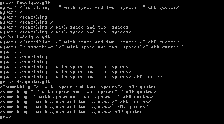

I didn´t ment it being a problem, only that two more double-quote characters has to be removed. See first print-screen. BTW I changed variable to an example which can easily led to an odd number of quotes on the FATCOPY.G4b command-line (latest double-quote character AFTER last slash). First run is your original Function13-batch, in the second run myvar is set between extra double-quotes, third run is the batch with my dd-approach, but already including your write (md)%mdmem%+1 %myvar%\0
dddelquotes_fair_comparison_with_Del_quotes_with_Fn13_and_Fn11_without_outside_quotes_and_adding_for_Fn.png.680517fdc37d501b0b68e4d54b2b5d1b.png

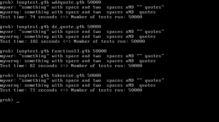

Tests are all run in VBox 6.0.18 r136238.
First print-screen below is testing while each batch-file has to be read from disk, so each run again.
803247309_VirtualBox_MS-DOS7.1_looptest.g4b_n50.000_met_wddquote.g4bde_quote.g4bfunction13.g4btokenize.g4b_no_insmod.png.bfc7472b45ef2246b312ef746c8326ed.png

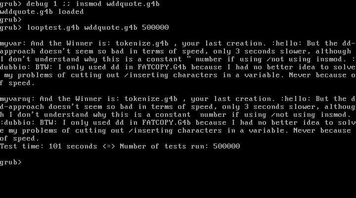

I also tried loading the four batches with insmod (using insmod with LOOPTEST.G4B was only about one second faster). Load-order or loading all batches at once made no difference.

And the Winner is: tokenize.g4b , your last creation. :hello:
But the dd-approach doesn't seem so bad in terms of speed, only 3 seconds slower, although I don't understand why this is a constant number if using /not using insmod. :dubbio:
BTW: I only used dd in FATCOPY.G4b because I had no better idea to solve my problems of cutting out /inserting characters in a variable. Never because of speed.

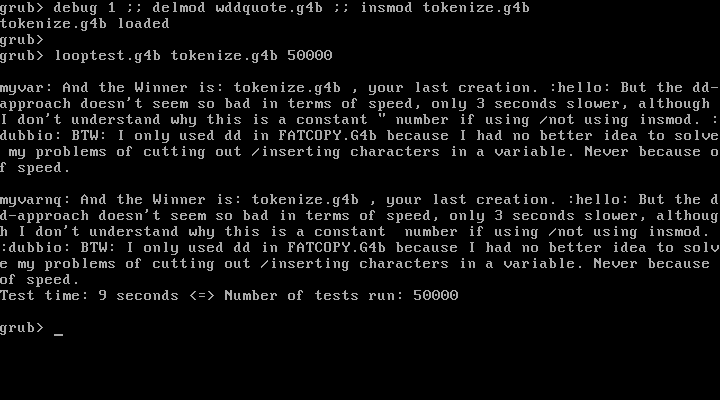

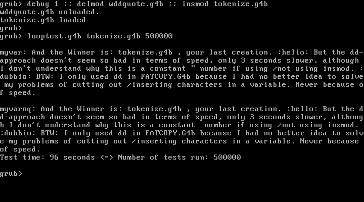

However, see the print-screens
1924683153_VirtualBox_MS-DOS7.1_looptest_g4b_n50.000_with_wddquote_g4b_with_insmod_not_on_looptest_g4b.png.14906519c72ee578960f5fd38769506f.png1723428522_VirtualBox_MS-DOS7.1_looptest.g4b_n50.000_with_tokenize.g4b_with_insmod_not_on_looptest.g4b_.png.dd9c1ed6ceb5b862a1c09bd6c5945751.png
Because 50.000 tests gave only a small difference (last digit is ±1 second), I raised the number of tests to 500.000 :crazy:
1355951216_VirtualBox_MS-DOS7.1_looptest_g4b_n500.000_with_wddquote_g4b_with_insmod_not_on_looptest_g4b.png.6809a56df823badec2d63f6627b0b893.png889643581_VirtualBox_MS-DOS7.1_looptest.g4b_n500.000_with_tokenize.g4b_with_insmod_not_on_looptest.g4b_.png.a47a971a79563a5b50ebfb1e597194ef.png
So the ´statement´ in variable myvarnq still holds approximately. With ONE double-quote character in myvar (instead of five), the calculated difference will be around ½ second per 50.000 runs.

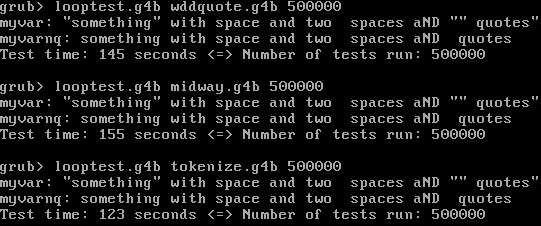

Because of the ±1 digit resolution, I raised the number of tests to 500.000 to get a measurable difference:
1737626785_looptest_g4b_n500.000_5_quotes_with_wddquote_g4bmidway_g4btokenize_g4b_with_insmod_not_on_looptest_g4b.png.339a722aa8dfd82e85e70cf9aec16834.png
Your ´midway´ seems to be slower than needed: I thought you would have had this in mind?

goto :noquotes2
Gives following results:
1737626785_looptest_g4b_n500.000_5_quotes_with_wddquote_g4bmidway_g4btokenize_g4b_with_insmod_not_on_looptest_g4b.png.339a722aa8dfd82e85e70cf9aec16834.png2102255171_VirtualBox_MS-DOS7.1_looptest_g4b_n500.000_5_quotes_midwayclean_g4b_with_insmod_not_on_looptest_g4b.png.ddaaa624ac8f73171a26a9d4020e71d3.png
Seems to be faster than, or as fast as your earlier tokenize-approach (±1 digit).
What´s your ´conclusion´ about speed of cat vs dd?

Sorry for the delay, but during testing smaller differences I got inconsistent results.
If one test-time is ±1 second, differences can be ±2 seconds, so ranges overlap easily (apart from load-time variations). I don´t like the ever longer time needed to do tests, so I made a new version of LOOPTEST.G4B. This took much more time than I expected, but nevertheless: I had a great time.:cool:
I managed to get a relatively stable time base and some semi-floating point operations to produce decimals. The stability depends upon the (virtual) hardware used.
Although I owe LimboX86 much for development-time on my Android smartphone, the time-base is very unstable, even in the ´whole second´ range. VBox 6 is better, but still unstable. Which is sad because of the productivity with ImDisk and the nice print-screens VBox is able to produce. I got my best results on a ASUS H61E board with Intel i3 (3,3 GHz) and DDR3 1333 memory (and I had to go back to GRAB.G4B. :wacko:).
BTW: all new test are done on the H61E-board, Grub4Dos is started from real-mode MS-DOS 7.1. So results can not be compared with the earlier tests in Vbox 6 (running under Windows 10 with AMD Bulldozer / DDR3 1666)!
This time I want to show my tests about the influence of insmod first, other comparisons will be done later. It´s also a very short introduction to the possibilities of the new version of LOOPTEST.G4B. The command-line of LOOPTEST.G4B has been changed a bit, to give room for arguments of a test G4B-file, besides other changes.
I compared MIDWAY.G4B and the cleaned version (three lines where not needed) with Short File Name MIDWAY#3.G4B. First I tested all files on a SATA flash drive, this is (hd0,0) on the first two print-screens. To compensate for internal delays in LOOPTEST.G4B I made a BIAS-variable. Further is variable 'myvar' set outside LOOPTEST.G4B (universal solution, names of input and output variable can be set on the command-line of LOOPTEST.G4B, and echoing can be done once, before and after the loops).
781193628_VirtualBox_MS-DOS7.1LooptestNOINSMODvsINSMOD1000MidwayvsMidway3SATAflashdriveTEST001.png.3edb9c8ae61758fa5a4450f2b3d64677.png
1599373534_VirtualBox_MS-DOS7.1LooptestNOINSMODvsINSMOD1000MidwayvsMidway3SATAflashdriveTEST002.png.25f644bd117b653016d54e1181c6e8de.png
The results without and with insmod are different, the variations in load-time seems to be bigger than the runtime-differences.

The last two print-screens show tests with number of digits set to three (by setting needed number decimals - rounding down). First test-cycle with 1000 tests does use ALMOST the same BIAS as earlier (the BIAS set during this test is slightly different; influenced by instabilities in the time-base and in the possibilities to divide the whole seconds.:no:
369177084_VirtualBox_MS-DOS7.1LooptestNOINSMODvsINSMOD1000MidwayvsMidway3OPMEMDRVvanuitUSB1.1TEST006.png.4d2c27ca850c917ec14ee6197abd4fa2.png
Without and with the use of insmod all differences are in the range of 42-43 milliseconds.
I expanded the test to 10000, 100000 and 1000000 loops, always three digits only (last print-screen).
1059889529_VirtualBox_MS-DOS7.1LooptestNOINSMODvsINSMOD10000-1000000MidwayvsMidway3OPMEMDRVvanuitUSB1.1TEST007.png.983fed985efe64b58de8e2eda56a8248.png
Without and with the use of insmod all differences are still in the range of 42-43 units, applicable to the different tests (0.01, 0.1 and 1 second respectively).
All in all, it seems to me that testing with insmod will give the ´right´, and the most stable differences. So next tests will be only with insmod, also to become independent of the device in use.
