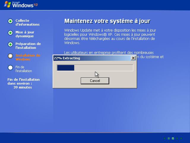

big_gie Posted April 19, 2004 Posted April 19, 2004 I'm using a 7zip autoextract file to unpack my drivers to the systemdrive @ T-39.[GuiUnattended] ... DetachedProgram="%systemdrive%\drivers\drivers.exe" Arguments="-y /q /r:n" ...drivers.exe is situated in <cdrom>\$OEM$\$1\drivers
[BM]Crusher Posted April 20, 2004 Author Posted April 20, 2004 big_gie is correct...you cannot set your DetachedProgram="program switch"it has to beDetachedProgram="program.exe"Arguments="switch"so yours would look like:[GuiUnattended] DetachedProgram="WinRAR_SFX_archive.exe" Arguments="/S"
