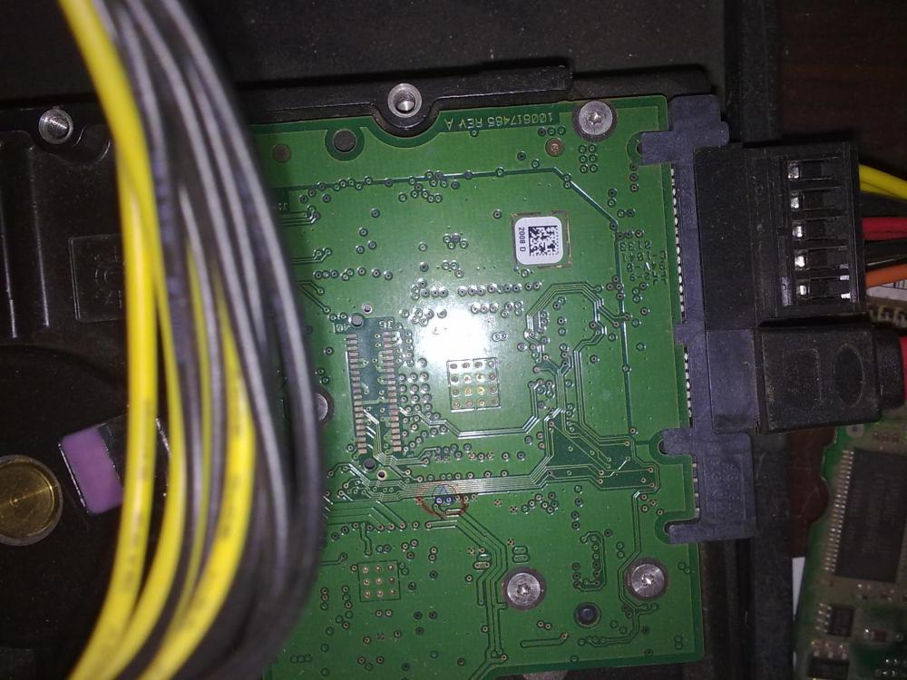

Do You mean this:
HI EVERYBODY
I HAVE FIXED THIS 2TB LP SEAGATE DRIVE.YOU DONT NEED TO SCARED JUST FIND OUT THOSE TWO PINS TO SHORT.SHORT IT FOR A WHILE AND YOU WILL GET READY IN STATUS BAR.THAN JUST POWER DOWN AND POWER ON YOU WILL GET YOUR DRIVE BACK .I AM STILL USING THIS DRIVE.DONT WORRY WHEN YOU HEARD SOME TYPICAL SOUND WHEN YOU SHORTING THESE PINS.ITS A PART OF THIS PROCESS.
KIND ATTN:PLS REFER THIS PIC GIVEN BELOW IF YOU HAVE SAME DIAG ERROR AS PEOPLE SHOWN HERE IN TERMINAL LOG.

HERE I HAVE ATTACHED ANOTHER JPG WITH CIRCLE ON POINT TO BE SHORTED ALL THE BEST. I HAVE WRITTEN WHAT I HAVE DONE.AND I GET SUCCESS EVEN JUST BEFORE THIS POST I HAVE APPLIED ON ANOTHER SAME DRIVE.SIMPTOMS HDD BECOMES INITIALIZED NO NOISE SMOOTH SPINING AND LOG FILE YOU ALL HAVE.THE PROBLEM START WITH YOU PEOPLE APPILED V4 V1 ANm format you will get this errror.So all the best to all and enjoy and share your success with others .
To make a short circuit on these pins?
5a75f4e462037_BaracudaST2000DL003sn5yd7skl6.thumb.jpg.30372694a1c901cf95a0b02c861edd36.jpg

Yes, that is one of those "green" disk drives that need a couple pads to be shorted (NOT for the faint of heart).
Besides that post, make sure to read this post AND the provided links:
Feel free to ask questions/express your doubts BEFORE risking to fry the PCB (or disk or both :ph34r:)

Many of these links do not work, but my version of pcb has rev.B and does not differ anything with the one in the picture (rev.A), the tracks on the plate run identically and I think that the rev.A from the foto is nothing different.
Good, but still do check the pins are the "right" ones with a multi-meter/ohm-meter before attempting shorting them.
Namely, here:
I posted an example (for a different model, but the "base" is the same).
jaclaz

Thank you for your help.
Hdd is working!!!
All what i had to do was keeping the READ pins shorted and turned drive pwr on.
Terminal stopped at "(P) SATA Reset" for a while so i removed jumper that was shorting the pins and drive console started to operate normally.
After connecting the drive to pc, all partitions were visible under windows 10 partition manager and under EASEUS Partition Master.
