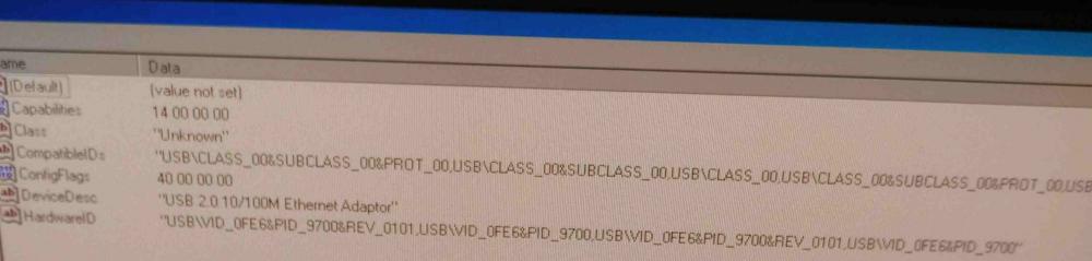

ruthan Posted May 1, 2017 Author Posted May 1, 2017 You will need to get the VID and PID for the Device from the Registry. Can you describe it with more details? When device is detected is detected like USB to LAN 10/100 adapter - but im asked to add drivers but i have only some exe to install them.. and even it is installed autodetection is not working and if some inf installed or added to system i really dont know which files are for my adapter.

rloew Posted May 2, 2017 Posted May 2, 2017 To find the VID and PID of an Unknown USB Device, run REGEDIT. Go to HKEY_LOCAL_MACHINE\ENUM\USB. You will see a list of VID and PID numbered Keys. Open each one and click on each Subkey. Disregard VID_0000. Look at the DeviceDesc Value String. If it says "Unknown" then you have found a Device with no Driver. If you find multiple ones, you may want to go into Safe Mode and remove all Unknown USB Devices and then start again.
ruthan Posted May 2, 2017 Author Posted May 2, 2017 (edited) Here is VID a PID you my USBtoLan Edited August 7, 2017 by ruthan

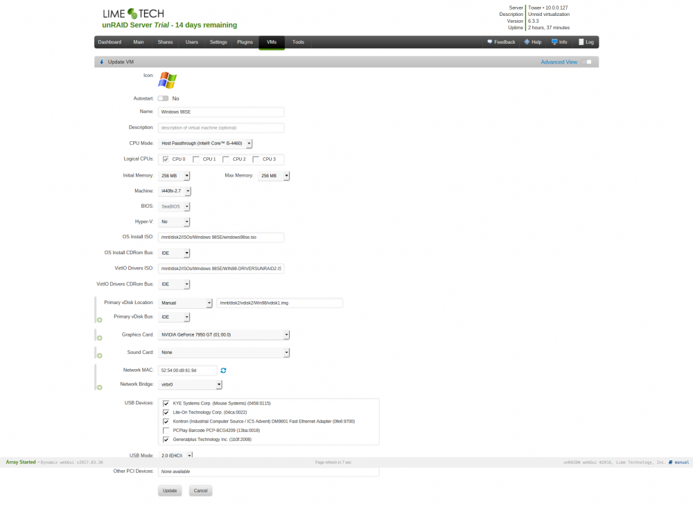

ruthan Posted May 3, 2017 Author Posted May 3, 2017 (edited) Just for info my HW: Newest Unraid - trial is OK, booting from USB - 1 Old 3,5 Seagate 320GB HDD for all unraid data, no parity driver, for VM is used only 10G Geforce 7950GT - MSI NX7950GT-VT2D512 - PCI-E 512MB - passthrouth to Win98 VM DDR 3 8 GB RAM signle channel, but for Win 98 VM is used only 256 MB Z97 board - Gigabyte GA-Z97P-D3 - Because of VT-d support and lots of slots for PCI-E devices // Only USB2 port forwarding is working, so USB3 is unless for Windows 98 unraid usage CPU Intel i5 4440s - only 1 core is assigned for Win 98 machine USB Audio - http://www.ebay.com/itm/182262415490?_trksid=p2057872.m2749.l2649&ssPageName=STRK%3AMEBIDX%3AIT - just 2$ stuff with free shipping and driver is on Win98 SE CD USB Lan - not working for now, but there people with working USB LAN in Win98 SE - import data to virtual to mounted ISO in virtualmachine, for ISO editing im using WinISO 6.1 Unraid settings: - enable Virtual machine module - look above, for boot from CD is needed, manualy edit Unraid xml to change boot device order - for installation have to be used VNC gpu driver - can bypass not working USB until USB controller driver is installled Edited May 3, 2017 by ruthan
ruthan Posted July 10, 2017 Author Posted July 10, 2017 Small update, you dont need USB to Lan adapter, its possible just edit machine XML to use virtual Realterk 8139 and for it, Windows 98SE driver exist.
