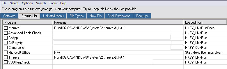

in regcleaner start up list I find 2 entrys with "Tfnruve".
They are reinstalled immediatly after removal. :)
Can somebody tell me more about this one.

I have hex edited the attachment you made (which I assume should have a .dll extension) and have found no reference to anything worthwhile. It appears it is either self-replicating, or called by an external program. I recommend an in-depth spyware scan.

I used Adaware and Spybot, they found some spyware but both programs had no problems with the "tfnruve" registery's. So they are still there. :)
I updated before scanning and the online check with pestpatrol does not include the tfnruve REG.
I have 4 accounts, in the the "Guestaccount" (never used) the 2 Registery are not in the start-up list. (and not made after using it with the programs I normal use in my account ).
Yes it is spelled like that, I checked different search machine and found no entrys. Then I posted it here. :)
Both registerys remain in place, but I have no other problems with the computer..(yet)
See image
self replicating, and its in run and runonce..
definately a virus or Spyware.
you tried removing all references to it in registry? also in Adaware or zonealarm set the regsitry to locked so that it cant continue to add itself to run on system startup.
Tried scanning in safemode? also tried Virus scan?
Computer became slow, the size of 'my account' had increased to 3.5GB !!
I removed the account, after that the "ftnruve" Registery on the 2 other accounts was gone (automaticly), i removed all the "ftnruve' files from the compuer. (in save mode) Problem solved, cause ??
