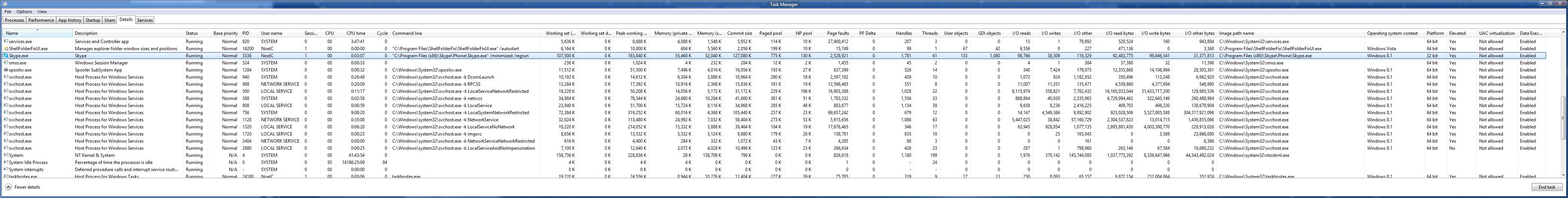

October 30, 20169 yr Author That's intriguing! Thank you, zolotron. Gems of knowledge like this are why I love this site. Out of curiosity, what resources do you see it using when run in the way you describe? For me, after having been running on my workstation for a day or so... Can't say I recall seeing any ads, but I have them blocked a number of different ways not having to do with Skype. -Noel Edited October 30, 20169 yr by NoelC

November 2, 20169 yr On 10/31/2016 at 0:25 AM, NoelC said: That's intriguing! Thank you, zolotron. Gems of knowledge like this are why I love this site. Out of curiosity, what resources do you see it using when run in the way you describe? For me, after having been running on my workstation for a day or so... Can't say I recall seeing any ads, but I have them blocked a number of different ways not having to do with Skype. -Noel This is for the desktop Skype which has run for about 10 hours today and compared to how it used to run when installing it straight it uses about half the resources. If you do install it straight with no mods you get an ad at the top of the chat window as well as sometimes at the bottom from Msoft targeted ads which can be turned off in the settings but the top ad has to be tweaked away elsewhere but using it the way I do I don't get any without the tweaks and you probably don't get any due to your host file entries and maybe other tweaks you did. I'm sure Msoft will find other ways to push ads and one wonders if when publishing such tweaks to help others it also helps MS finding ways to disable it so can push more crap down that pipeline

November 2, 20169 yr Author 7 hours ago, zolotron said: This is for the desktop Skype which has run for about 10 hours today and compared to how it used to run when installing it straight it uses about half the resources. If you do install it straight with no mods you get an ad at the top of the chat window as well as sometimes at the bottom from Msoft targeted ads which can be turned off in the settings but the top ad has to be tweaked away elsewhere but using it the way I do I don't get any without the tweaks and you probably don't get any due to your host file entries and maybe other tweaks you did. I'm sure Msoft will find other ways to push ads and one wonders if when publishing such tweaks to help others it also helps MS finding ways to disable it so can push more crap down that pipeline Looks like we've accomplished the same things in different ways. Your Working set and Commit size are actually showing as larger than mine. Thanks for letting me know that my ad (and SkypeBrowserHost) blocking strategy is effective with Skype. I didn't realize that others see ads in the places you described. -Noel

November 2, 20169 yr 7 hours ago, NoelC said: Looks like we've accomplished the same things in different ways. Your Working set and Commit size are actually showing as larger than mine. Thanks for letting me know that my ad (and SkypeBrowserHost) blocking strategy is effective with Skype. I didn't realize that others see ads in the places you described. -Noel Yes I was wondering about the difference in the Working set and Commit size difference and I'm using version 7.29.64.102. See below what it looks like without mods and it must become very annoying for those who use Skype as is Edited November 2, 20169 yr by zolotron
