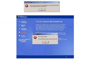

Jazz Posted April 3, 2004 Posted April 3, 2004 HI. i have created the cd as the guide but when i complete evrything i get a strange error during the gui setup.... i'm attaching the pic..Bye,jazz
GreenMachine Posted April 3, 2004 Posted April 3, 2004 Welcome to XPCREATE, Jazz!Hate to surprise you ... but my first suspicion is always user error ...Find the file XPCREATE.LOG that was used when creating thee CD (or try again, and save that file). It should be in the NEWFILES subdirectory. Attach (not post) with your next post, and I will take a look when I get a chance.

Jazz Posted April 5, 2004 Author Posted April 5, 2004 HI, thanks for the replies, i tried doin what u said , but i'm still getting the same error !GM please let me know what the possible error could be !Bye,Jazz
GreenMachine Posted April 5, 2004 Posted April 5, 2004 You got me on this on, Jazz. From the looks of the log, I would not expect an error. Please try again with the slightly modified, attached XPCREATE.CMD, and post your XPCREATE.LOG file once again.Waiting on you ...
pup Posted April 13, 2004 Posted April 13, 2004 I had the same error.Got round it by removing some of the extra packages from the SVC-PRE, SVC-WMP & SVC-X2M folders I think.I'll try and narrow it down, by adding them back it.(And before you say anything... If I can't work it out then I'll post my log file )
pup Posted April 13, 2004 Posted April 13, 2004 @Jazz - I think it's down to the Q832894 hotfix - which would make sense as it is one of the files that it updates that it is complaining about 'SHLWAPI.DLL'.I re-downloaded my copy, using the XP Hotfix Auto Downloader by Jono (http://www.msfn.org/board/index.php?showtopic=15555), and there is a difference in filesize:Yours (and my old version):01/16/2004 03:37 PM 3,083,512 Q832894.exeMy new version (that works):13/04/2004 05:51 2,907,904 Q832894e.exeDon't know where I got mine, but I don't care. All is now happy... @GM - Top marks on a cracking set of scripts. Talk about easy to use! Keep it up.
