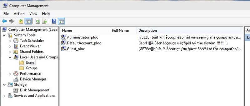

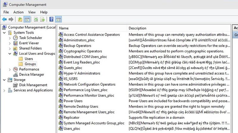

Tripredacus Posted May 11, 2015 Posted May 11, 2015 Went into CMD and noticed the user account was Administrator_ploc, so I went into the Users and Groups cpl and see these: Groups are hit and miss... What is the cause of this?
NoelC Posted May 11, 2015 Posted May 11, 2015 Hm, I'm not seeing the _ploc suffixes or font corruption here. I thought maybe it might some kind of nomenclature related to it being a local account on a system tied to a cloud account, so as a test I converted to use a cloud account. No difference... Still doesn't show anything like what you're seeing. -Noel
NoelC Posted May 11, 2015 Posted May 11, 2015 Seems very suspicious that the letters are readable, but with wacky visual mappings (e.g., the pi symbol for 'n'?). That looks to me like the kind of thing malware might do. I'd certainly suggest a scan for a rootkit with MBAM. -Noel
Tripredacus Posted May 11, 2015 Author Posted May 11, 2015 It appears this only happens in Audit Mode. User and Group descriptions and names look normal after running sysprep. Also the Start Menu and taskbar work normally now.
