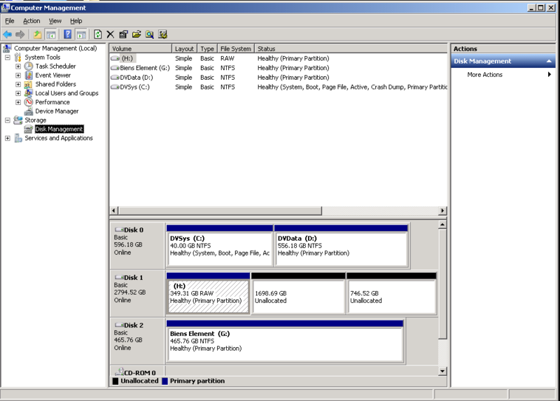

And heres a screenshot from windows:
I can't seem to see any data on the HDD anymore since  its not being recognized as formatted, so there's no way to make a backup! The drive still shows up in Windows Device Manager, but it shows up in Windows as a RAW drive (primary partition), with 2 other unallocated partitions. It was originally formatted as NTFS. I tried booting from Linux Ubuntu but can't see the the drive either.
 I have already connected it to different machines and on a HDD dock as well. Still the same.
What do the HDDScan results mean? Can you recommend  troubleshooting and data recovery software/methods? Would running these utilities cause further harm? For fear of damaging the disk further, I have not run chkdsk or testdisk on it yet.
Please excuse the newbie question, Is my drive the notorious 7200.11?

The Disk Manager view instead seems to be meaning that the disk is functional (good) but that has lost (partially or totally) the volume informations.

Which OS are you running? > Windows 7
Is it an internal or external disk? > External
How exactly (under which OS and with which tool) was it originally partitioned? > Windows 7, disk management
Which was it's use (i.e. a backup drive, a "main" drive, almost empty, almost full, recently defragged, etc)?  > it was connected to an all in one touchscreen desktop (HP touchsmart), and was storing recorded tv programs and was also a repository of pictures and videos.
