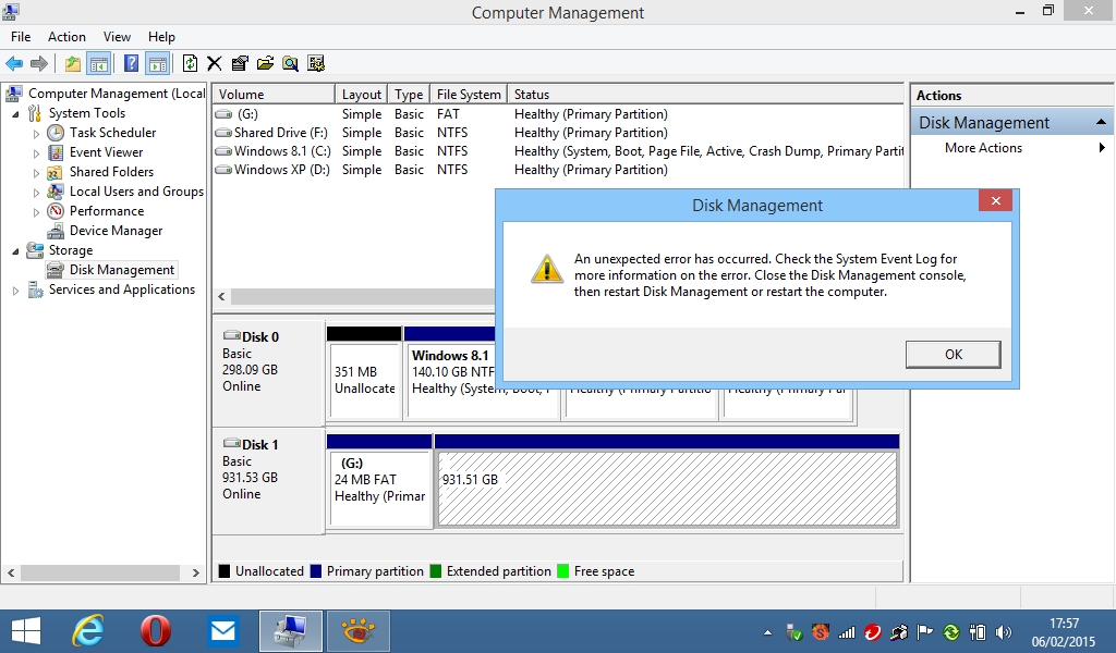

I tried the disk routine again, creating a 3 MB drive initially this time instead of 32 MB.
All seemed OK on the USB side -
Microsoft Windows [Version 6.3.9600](c) 2013 Microsoft Corporation. All rights reserved.C:\windows\system32>cd\C:\>cd mkprilogC:\MkPriLog>mkprilogplease input an approximated size in Megabytes for the FAT12 partition, minimum1, maximum 32...The image will be created in the same folder as this batchand will be named PriLog.img3Writing MBR at offset 0 ...... done.... done.Writing the 512 bytes/sector bootsector BPB at offset 32768 ...BS512_Res=456BS512_SBef=64BS512_Sectors=6080BS512_SpF=8... done.... done.Writing the 4096 bytes/sector bootsector BPB at offset 262144...... done.Writing FAT tables incipit ...... done.Base address of EPBR 512 is 389120Base address of EPBR 4Kb is 3112960Press any key to continue . . ..The image should have been created as PriLog.img, now you need tomanually dd it to the destination disk, a suitable command would be:dsfi.exe \\.\PhysicalDrive[n] 0 0 PriLog.imgMake sure that you use the RIGHT Disk Number [n], do check in Disk Manager.The disk can be mounted indifferently through the 4kb or the 512bytes/sector interface to deploy the image.Once the image has been deployed you may need to disconnect and reconnect thedisk to have the FAT12 volume be recognized and mounted.Then you can go to Disk Manager and create a Primary partition, NTFS formattedextending on all the available space on disk (or on just a portion of it).It is "better" to use a Vista (or later) OS to create the NTFS partitionThe partition would be better if Megabyte aligned.(or do it manually or use a suitable third-party tool) as the XP will align iton head/cylinder boundaries, whilst a MB-aligned partition will be faster onslow buses such as USB 2.0The partition and the NTFS filesystem MUST be created when the disk is connected asa 4kb sectored device, this is NOT negotiable.Once the second partition has been created, and I repeat, this MUST be donewith the device connected as 4kb sectored, you can run the mkdualdisk.cmdWhich will modify the disk and create the needed EPBR's.C:\MkPriLog>dsfi \\.\PhysicalDrive1 0 0 PriLog.imgOK, written 3145728 bytes at offset 0C:\MkPriLog>mkdualdisk"DUAL" disk found as \\.\PHYSICALDRIVE1Creating a temporary copy of the MBROK, 4096 bytes, 0.047s, MD5 = 66f00e2856e8fb53d8d47fa8a0c974bdNow the extent of the FAT12 partition is 704We need to multiply this value by 8, once increased by 64, and then subtract 64Offset 474=0xC0,0x17,0x00,0x00Now the extent of the FAT12 partition is 6080000001B8h: 44 55 41 4C DUAL000001BEh: 00 00 00 00 0F 00 00 00 3F 00 00 00 01 00 00 00000001CEh: 00 00 00 00 01 00 00 00 40 00 00 00 C0 17 00 00000001DEh: 00 0C 0D 00 07 FE FF FF 00 03 00 00 00 08 8E 0E000001EEh: 00 00 00 00 00 00 00 00 00 00 00 00 00 00 00 00Condition #1, Prilog=1Condition #1, Prilog=2Condition #1, Prilog=3Condition #1, Prilog=3Condition #1, Prilog=4Condition #1, Prilog=5Entry446=000000000F0000003F00000001000000Entry446_Length=1Entry446_LengthHex=00000001Entry446_Start=63Entry446_StartHex=0000003FEntry446_Type=0FEntry462=000000000100000040000000C0170000Entry462_Length=6080Entry462_LengthHex=000017C0Entry462_Start=64Entry462_StartHex=00000040Entry462_Type=01Entry478=000C0D0007FEFFFF0003000000088E0EEntry478_Length=244189184Entry478_LengthHex=0E8E0800Entry478_Start=768Entry478_StartHex=00000300Entry478_Type=07Entry494=00000000000000000000000000000000Entry494_Length=0Entry494_LengthHex=00000000Entry494_Start=0Entry494_StartHex=00000000Entry494_Type=00sum462=6144by8=6144by8XP=5640The disk was recognized as created with the Prilog schemeCreating a temporary copy of the NTFS partition bootsectorOK, 4096 bytes, 0.000s, MD5 = 00fd23983d9c4d7123f9eade7f752b1ePress any key to continue . . .Creating a copy of the 4kb bytes/sector NTFS bootsectorAnd modifying it to become the 512 bytes/sector NTFS bootsectorOffset 11=0x00,0x02,0x08Offset 28=0x00,0x18,0x00,0x00Offset 40=0xF8,0x3F,0x70,0x74OK, 4096 bytes, 0.000s, MD5 = b4a25b364281dc40e3203fbacd9df49bPress any key to continue . . .Creating a copy of the 4kb bytes/sector EPBRand writing to it the values for the NTFS volumeOK, 4096 bytes, 0.000s, MD5 = fc86b746e3b8c6f0108aaf1a1ac6271aOffset 450=0x07Offset 454=0xC1,0x02,0x00,0x00Offset 458=0x00,0x08,0x8E,0x0ECreating a copy of the 512 bytes/sector EPBRand writing to it the values for the NTFS volumeOK, 4096 bytes, 0.000s, MD5 = 620f0b67a91f7f74151bc5be745b7110Offset 4034=0x07Offset 4038=0xC1,0x17,0x00,0x00Offset 4042=0x00,0x40,0x70,0x74Press any key to continue . . .If you are on Vista or later you may need to authorize three timesthe writes to disk (UAC prompt)Press any key to continue . . .OK, written 4096 bytes at offset 0OK, written 4096 bytes at offset 29672OK, written 4096 bytes at offset 258048C:\MkPriLog>
After formatting the NTFS partition everything was correct as expected on the USB machine.
I then switched the disk over to the eSATA interface.
The 3 MB drive appeared but nothing else.
I then realised that I hadn't copied the necessary switching files to it, so I decided to go back to the USB interface to do it (as that's where I would have done it had I not forgotten!)
The 3 MB drive reappeared on the other machine, but not the large NTFS drive which had been there before.
Disk Management is now showing it as a primary partition with no file system or drive letter.
It doesn't say it's RAW unformatted, but if I try to do anything (like format or change drive letter) Disk Management just throws up an error message.
Rebooting makes no difference, and there are no relevant entries in any of the system logs.
I did nothing on the eSATA machine other than switch the disk over to it and open the small drive, but it looks as if just doing that has corrupted the structure when back on the USB interface!

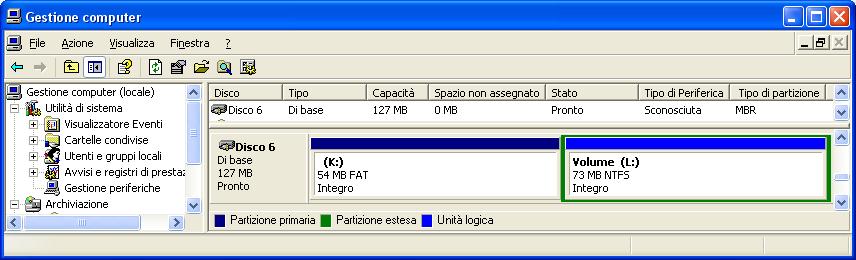

The one "on the left" is related to the disk mounted as 512 bytes/sector and shows:
  1. a primary FAT12 partition 7 Mb in size (i.e. the size I used in mkprilog.cmd)
  2. between the above and the below the "fake" unallocated
  3. a logical inside extended NTFS volume the size I created it (i.e. around 73 Mb)

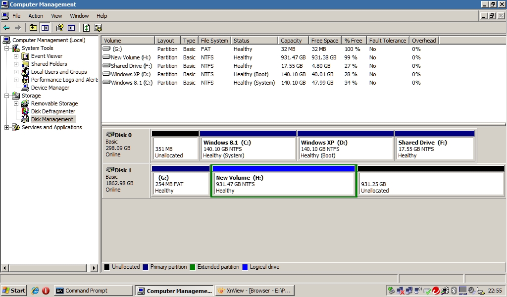

The one "on the right" is related to the disk mounted as 4096 bytes/sector and it shows:
  1. a primary FAT12 partition 54 Mb in size (i.e. the size I used in mkprilog.cmd multiplied by 8)
  2. a logical inside extended NTFS volume the size I created it (i.e. around 73 Mb) immediately following the above
Can you try again, this time giving 7 Mb as input in the mkprilog.cmd and creating a NTFS partition of 73 Mb?
(this way the disk manager views in XP should be similar to the ones I obtained)

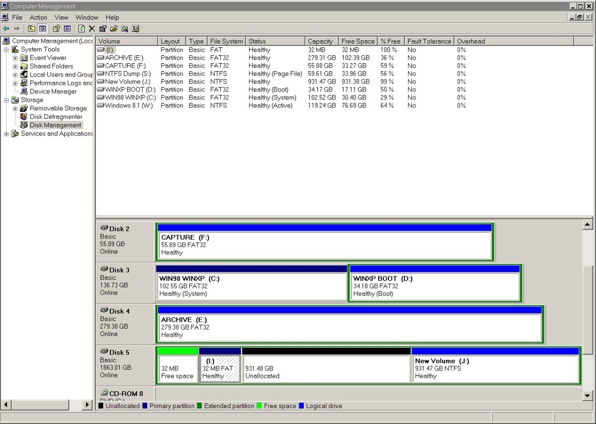

Hi jaclaz.
Before doing anything else, I just wanted to let you know completely what is happening with XP at the moment.
Going over to the eSATA machine and running switched worked fine, although as you can see the resulting layout in Disk Management is even stranger than it is on the USB machine!
post-84253-0-60964000-1423748760_thumb.j
From what you say however, this does not matter, but you should mention it in the readme file so people don't panic!
The drives are actually working fine.
