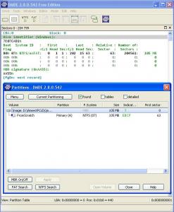

jaclaz Posted September 28, 2014 Share Posted September 28, 2014 No. In the sense that I strongly doubt that a NTFS filesystem can be found on 8th sector on a hard disk like device. Normally the VBR of first volume on any partitioned device is (depending on the disk setup/partitioning tool used and under which OS) is normally at offset 63 sectors (before Vista) and at offset 2048 sectors (Vista and later). Are you sure about this "8th sector"? Are you sure you provided the disks in th eright order (or that they were identified properly)?Do you have now a non striped image? Check the first sector of the image (or first sector of both devices).It should be normally a MBR (even if GPT, it would have a "protective" MBR entry). You can access the device or image with DMDE, you should have a situation similar to the screenshot attached (IF the MBR data is still valid). jaclaz Link to comment Share on other sites More sharing options...
Craigst Posted September 28, 2014 Author Share Posted September 28, 2014 this is what i get what can i do from there to ? to get ntfs partition to a disk drive Link to comment Share on other sites More sharing options...
Craigst Posted September 28, 2014 Author Share Posted September 28, 2014 on volume 2 it says i can restore on ntfs ? Link to comment Share on other sites More sharing options...
jaclaz Posted September 29, 2014 Share Posted September 29, 2014 Well, then it's OK, it is the RAID sector (the data in the MBR is about CHS 8/0/1 whilst the LBA is 8 sectors), either is a "peculiarity" of the RAID setup or the disk has been partitioned with a third party tool.However, the "main" volume is the one corresponding to line:HD Primary(A) NTFS(07) 238Gb EBCF 8 464 842 744which is also seemingly in "good shape" (at least when it comes to "primary" descriptors) as you have the EBCF in green.http://dmde.com/manual/partitions.html You should select that line and then click on "Open volume", the other ones are "false positives". jaclaz Link to comment Share on other sites More sharing options...
