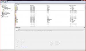

ND22 Posted May 5, 2013 Author Posted May 5, 2013 I don’t know if this helps or not but the only error message I find every time the computer was booted on in event viewer is about MSE; here is the screenshot:
