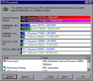

It seems now I'm in a total loss: I upgraded to VMWare Workstation 9.0.2 (the latest) and have redone all my steps. Win95 now boots and everything looks nice. SiSoft Sandra now shows some more accurate results:
post-376300-0-27639300-1365322263_thumb.
