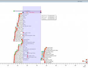

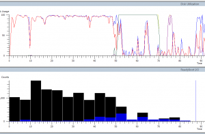

MagicAndre1981 Posted September 12, 2012 Author Posted September 12, 2012 boot is terrible broken. The prefetcher doesn't work as it should and your DISK is busy all the time:What I can see is that the NOD32 service takes some CPU time and this causes the slow WinLogonInit phase:So you should also run the boot optimization I've explained here:http://www.msfn.org/board/index.php?showtopic=140262but it is better to sue the new Hybrid Boot / fast Startup feature of Windows 8:http://www.msfn.org/board/index.php?showtopic=152937

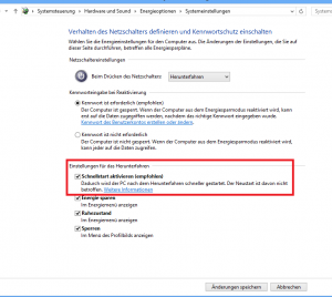

MagicAndre1981 Posted September 12, 2012 Author Posted September 12, 2012 In the power saving options you should have an option to select fast startup:Now Windows should use the new boot.
Traditore Posted September 13, 2012 Posted September 13, 2012 (edited) In the power saving options you should have an option to select fast startupIt IS selected, and it was all the time. Now, silly as I am, I tried to disable it, save changes, and then enabling again... and for the first time I saw what fast startup is. LOL? Now it's functioning.And after boot optimization, disabling NOD and using windows defender, I got to 50 secs boot after restart. Is that OK? Edited September 13, 2012 by Traditore
