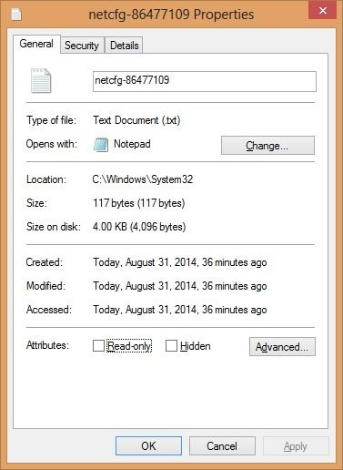

They should be far less than 1 Kb, which poses another question, such small files don't normally go into the (NTFS) filesystem (they should be written directly into the $MFT).
Having thousands of small files is not IMHO as much an issue with actual size occupied (besides making browsing the filesystem with Explorer or other file manager a nightmare) but rather with size (and number of entries) in the $MFT :unsure: .
jaclaz
Of course less than 1KB... but Explorer (details) doesn't show any size lower than 1KB. I checked mine here and file size is 117 bytes with Size On Disk of 4,096 bytes.

Yes, this latter is the "expected" result.
The "vcredist_x64.exe" file has actually a (single - meaning that it is NOT fragmented) extent on disk, (though the 1220 sectors do not sound "right" :w00t: ), whilst the netcfg-86477109.txt has NONE (because it is self-contained in the $MFT entry).
It was only to show you how and why the "4.00 KB (4,096 bytes) is a "lie" (or if you prefer "a glitch in the matrix"). ;)
If you have (say) 10,000,000 :ph34r: of such files, the capacity of the disk won't be reduced by 10,000,000*4,096 bytes = ~38 Gb but the $MFT will have some 10,000,000 more entries and probably will be larger by around 10,000,000*1,024 bytes, i.e. your available space will be reduced by about 1/4th of the above, but the $MFT will be HUGE.
