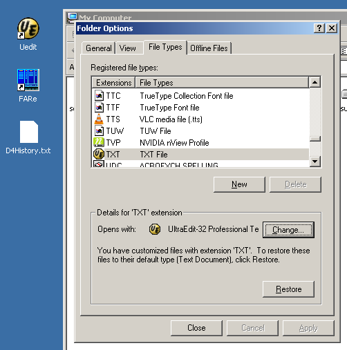

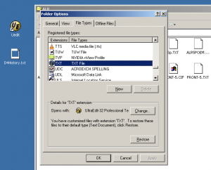

Asp Posted June 27, 2012 Author Posted June 27, 2012 (edited) Do they look like this one?Not quite. No shadow or underline. Just a plain white rectangle with one corner cut. So invisible on a white background. See below.Explorer->Tools->Folder Options->File TypesFind the "bad ones", click once on it/them, click Advanced->Change IconThere is no "Change icon" option for these. Only "Restore", which puts the association back to Notepad.See screencap.The file "D4history.txt" shows the icon that I have now for txt files. Just a blank, white rectangle.For "TXT" the Standard Icon is in "C:\WINDOWS\system32\shell32.dll"For "AVI" it's "C:\Program Files\Windows Media Player\wmplayer.exe"For that "AVS" it could very well be inside the Program in question.IF "AVS" isn't there, I couldn't tell you... that program probably should have been Installed to "create" that type.AVS is Avisynth; actually the type was created when I installed that, with the default app Windows Media Player, which I change to VirtualDubMod.There is no problem with default associations.You "copied" the folders and expected the Registry to be updated. I'm really unsure if there are actually other files necessary.Of course I don't expect the Registry to update itself. That's why I asked how to do it.Plenty of apps can be simply installed by copying and work. with a bit of tweaking; that's what "portable" apps are.I do it for some apps to preserve my settings from an archived version.This is the first time I've had the problem with icons, having done it many times before. Edited June 27, 2012 by Asp
