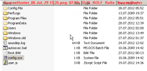

Takes some time to learn screen hunter, but maybe the attached file is ok. Folder option set to show hidden files, but they are not there. The disk seems to have had an OS before installation, maybe I should try again, full formatting the partition first?
post-358790-0-81236600-1343576688_thumb.
Posted (edited)
NO.
You must set settings so that you see both hidden and system files.
You want to have "Hide protected operating system files (Recommended)" UNchecked.
You should also have normally in root (additionally):
  • pagefile.sys (the page file)
  • $Recycle.bin (the Recycling Bin)
  • System Volume Information (another system/hidden folder)
and probably quite a few other files that do not show in your screenshot.

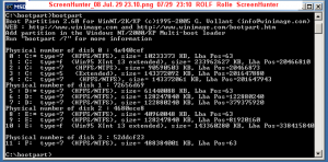

Got a 3rd line, default entry in the menu but still no Win 7. Messages flashing during the loop seems to be info only, not error msgs.
Edited by Roffen
It looks like this:
[boot loader]
timeout=30
default=multi(0)disk(0)rdisk(0)partition(1)\WINDOWS
[operating systems]
multi(0)disk(0)rdisk(0)partition(1)\WINDOWS="Microsoft Windows XP Professional" /noexecute=optin /fastdetect
C:\Windows7.bin="Windows 7 disk"
XP: OK
Win7: Loops back to the menu instead of booting Win7
Are you positive that you used bootpart correctly?
Can you post the output of the boopart command (run without parameters)?
It's strange, it should have worked :unsure:

decompress the files grldr and menu.lst in root of first disk.first partition (the XP volume)
add to the BOOT.INI the line:
C:\grldr="grub4dos"
reboot and choose that entry.
At the grub4dos menu try all the entries.
Whilst first one may fail, the other two should both work :unsure:
