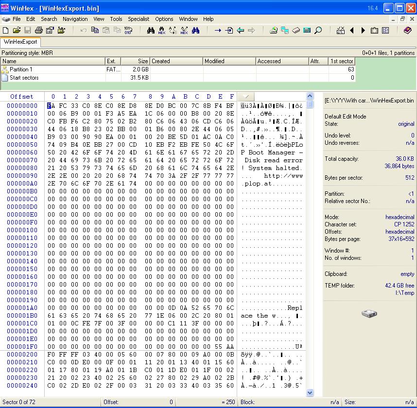

Dave-H Posted April 16, 2012 Author Posted April 16, 2012 So, back to square one: 1) Verify that you're really selecting USB-HDD as the fist boot device. And, if so:2) Try again to export a binary inmage of the pendrive as per my intructions some posts above, but this time use 0 as the start and 9000 hexadecimal or 36864 decimal as the end of block. I guess WinHex will allow you to export this file, since it's just 36 KiB. Then zip and attach it, please.OK here's the new WinHex export.I hope it provides a clue what's going on!WinHexExport.zip
dencorso Posted April 17, 2012 Posted April 17, 2012 OK. The good news are: the SYS procedure worked as expected.Now the bad news: The Plop BootManager remains at LBA 0 (place of the MBR).So, under Win XP, repeat please the procedure using MBRWiz, as described in post #15 (I've just revised it to make it clearer).Pay a lot of attention to any output produced by MBRWiz and report it, please (screenshots of the dos box are also welcome)
