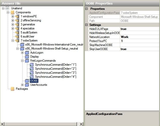

Tripredacus Posted February 21, 2012 Posted February 21, 2012 On my TS Properties, on the OS Info tab. I press "Edit Unattend.xml" which will open the XML in WSIM. I see that in the OOBE object, the NetworkLocation default value is "Work." Try changing this to Public and try again.
bookie32 Posted February 21, 2012 Author Posted February 21, 2012 Hi mate!OK as soon as I get a mo I will try that....and get back to you.Thanks!bookie32
bookie32 Posted February 21, 2012 Author Posted February 21, 2012 Hi again!OK the only settings under that are Home, Work, and other, so I have set it to other to try that....bookie32
Tripredacus Posted February 21, 2012 Posted February 21, 2012 Hi again!OK the only settings under that are Home, Work, and other, so I have set it to other to try that....bookie32Yes, sorry. I don't know why the Unattend setting uses different words than what actually shows up on that screen.
bookie32 Posted February 21, 2012 Author Posted February 21, 2012 Hi mate!No worries...I diactivated the media service as stated in a previous post and then changed the Unattend settings to "other" and that did the trick OK! now I need to test the wim on a different computer and we are starting to get somewhere.....YES!Nice find mate!Thanks a bunch I have logged back into the computer after syspreping it and all my programs are working fine....Now to deploy the wim to my main computer and get back to some real work....lolbookie32
