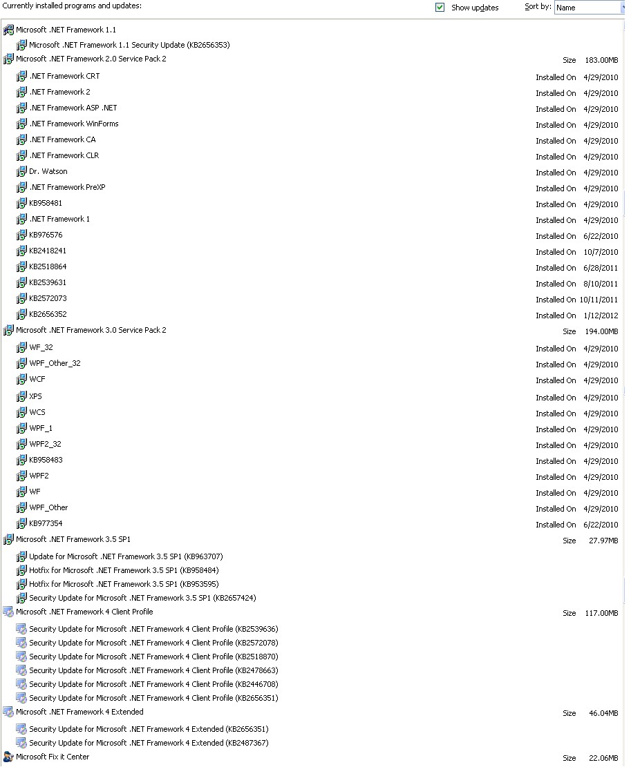

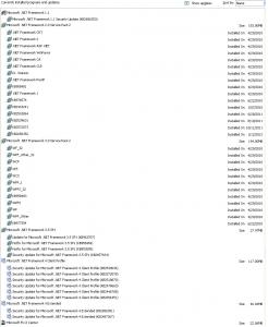

Hello ~
Hoping to find some help here. I have a problem with KB2657424 constantly updating. I get the automatic Windows Update almost immediately after having run it. I went into Windows Update online and tried it from there thinking perhaps that would make a difference. It didn't. Even Windows Update, although it shows this update being SUCCESSFULLY updated numerous times over the last month, it will still ask me to install it again.
I have tried Microsoft Fix It to no avail. I have made sure that everything else having to do with .NET Framework is up-to-date.
I am attaching a photo of all of the .NET Framework items which are currently installed on my XP SP# system.
Any suggestions as to how to get this update actually successfully installed would be appreciated.
Thank you!
~ Cindy
