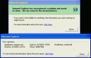

dencorso Posted August 26, 2011 Posted August 26, 2011 This link crashes my IE8 about 3 of every 5 times I attempt to view it. The crash either is a silent closing of IE8 or a message box, with the usual mention of a report. UOL is a big news portal in Portuguese, so avoiding it is not an option.I'm having problems with UOL only, so my set-up apears not to be a problem. I didn't yet catch a report from that link in particular, but I'm attaching reports from previous ones that exhibited the same simptoms (and all 3 I've cached, from different links, are binarily identical). And yes, navigating In-private with no add-ons lowers the probability of crashing IE8, but by no means avoids it entirely. Please advise.8150_appcompat.7z

dencorso Posted August 26, 2011 Author Posted August 26, 2011 I'm using Win XP SP3. All Vista and Win 2003 files present stem from IE8 or its updates.I've updated flash. Thanks, 5eraph, for the heads up! However, the crashes continue. IE8 crashed 7 times in 10 attempts, this time.BTW, I'm using a custom hosts file, too. But perhaps it's less restrictive than the one you're using, allen2.

dencorso Posted September 3, 2011 Author Posted September 3, 2011 I've sorted it out! And it's a catch-22 situation. Turns out that, in july, while trying to disable a nagging prompt IE8 presents on reopening, every time it's killed or when it crashes, I disabled "Enable automatic crash recovery" as recorded in the "Auto-"go to homepage" in IE8... Is there a way to do it?" thread, which last post I quote below, for easy reference:But now I've found the answer: Go to Tools --> Internet Options --> Advanced --> Browsing and untick "Enable automatic crash recovery"That suppresses the dialogue box, after IE crashes. And then it goes to the default homepage, as required.I'm posting it here just for the record, so that others may find it, on searching.And it worked OK for a while, then UOL made some "HTML Updates" to its pages and the crashes described in this thread began.However, when I re-enabled "automatic crash recovery", the crashes still happen, but IE8 recovers from them seamlessy, so they are imperceptible, unless one causes the machine to really slow down. Hence, there's more to the "Enable automatic crash recovery" setting than the nag prompt I was keen on disabling, and it's really not advisable to untick it. I guess it's best to put up with the occasional nag screen, than to use two browsers on a regular basis.@Joseph_sw: True enough. Proxomitron can solve it, but I'd have to identify all offending tags, by trial and error...In any case I'll look into it further, since I've been considering adding it to my setup for a long time already, and this may be a good time for it. Thanks for the suggestion.

dencorso Posted September 17, 2011 Author Posted September 17, 2011 @MagicAndre1981: As soon as I manage to do it I'll post it.Menwhile I've see the same crash happen in at least 7 different machines at work, all of them having plain vanilla XP SP3 installations with IE8.The site for getting the crashes is the main page of the UOL news portal. It's content varies by the day, but clicking on news links and then in news links inside the newly arrived-at page, sooner or later causes a crash. And disabling the "automatic crash recovery" reults in either the messages in the 1st post or in IE8 closing suddenly. This also seems to be a bug known to MS, but fixed only for latter versions of windows (see: KB979665).
cluberti Posted September 19, 2011 Posted September 19, 2011 That fix is from 2010 (included in MS10-002), and the error is very generic. There's no way to tell if the fix from 979665 is actually for the issue you are seeing without you getting a crash dump and comparing that versus the fix.
