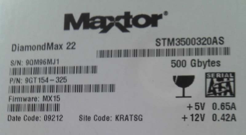

saman0suke Posted August 24, 2011 Posted August 24, 2011 (edited) Good day, I found this forum searching for a solution, I'm already losing any hope, so, I will do my last effort I have a Maxtor STM3500320AS DiamondMax 22 SATA 500 GB, which suddenly stopped working, I was not able to see it on Windows Ultimate x64, so I entered into Ubuntu x64 and gParted advised me to run CHKDSK on the disk since it had problems, I tried to do it with the Windows Installation disc, but it didn't work, because It did not see the disk.I checked BIOS and I can see the hard drive, I put the hard drive on an enclosure and logged in on Windows, and I was able to see my two partitions (1 about 100 GB and the other 400 GB aprox) but when I tried to enter it said "Do you want to format this drive?" so I canceled it, I tried to use severalrecovery data applications with no success, most of them just get frozen when the scan starts, and launches a lots of error of the type I/O error.If I try to go to Windows Management Disks, I can see the hard drive as Not initialized, when I try to "mount" it, it says that I cannot do the operation due to an I/O error.Checking on the Seagate forum, I noticed that an importante firmware update was available for my hard drive (I was on MX15) and I installed it on the drive, with no problems at all, but now, everytime I want to boot up the computer with the hard drive connected to the motherboard, the computer stays "loading" at the INTEL screen and never goes forward, I have to disconnect the drive, boot up any OS and then connect the drive, using an enclosure, or connecting the sata cable after the OS is loaded.I still have some hopes to recover something, I just care about maybe 20 GB of the small partition, if you have any idea, I would like to give it a try because right now i'm out of them, I checked about a BSY LBA0 error, something that happens with this hard drives, but I don't know if I have this problem, please guide me, at this point, I'm ready to try any method to save some data from it, I'm pretty sure the data is fine, thanks in advanced, have a nice day!! I attached an image of the actual Hard drive info, if works for someone.EDIT: I was thinking on getting an exact hard drive to replace the Logic board, could this be a possible solution? thanks!ESPAÑOL:Para hacerlo un poco resumido, tengo un disco duro Maxtor DiamondMax 22 STM3500320AS 500 GB SATA, de repente dejo de funcionar, no lo veia en Windows 7 Ultimate 64 bits, fui a Ubuntu x64 y gParted me recomendo hacer un CHKDSK el cual no pude realizar ya que al insertar el disco de Windows no me reconocia el disco duro, he tratado de utilizar muchos programas de recuperacion de datos o sectores dañados y la mayoria terminan congelandose y lanzando errores de tipo I/O (entrada/salida).Si voy a la admin de discos en Windows, puedo ver el disco duro pero esta como "No inicializado" y si trato de montarlo me dice que ha habido un error de I/O, a este punto la unica de ver el disco es colocandolo en un enclosure, y puedo ver las dos particiones que posee, pero me pide que los formatee antes de entrar puedo ver el disco duro en la BIOS sin problemas; revisando los foros de SEAGATE me doy cuenta que hay una actualizacion de firmware para este modelo, la aplique, pensando en una solucion y ahora, cada vez que quiero iniciar la pc con el disco duro conectado a la motherboard, este se queda cargando en la pantalla de INTEL y no pasa de ahi, tengo que iniciar sin el disco duro conectada, y cuando el SO este cargado completamente conectar el disco duro, estoy seguro que aun puedo recuperar alguna informacion.He pensado en obtener un disco duro identico y cambiar la placa logica, pero no se si funcionaria, o realizar el procedimiento para resolver errores de tipo LBA0 o BSY, cualquier ayuda es bienvenida, gracias Edited August 24, 2011 by saman0suke
jaclaz Posted August 25, 2011 Posted August 25, 2011 (edited) Checking on the Seagate forum, I noticed that an importante firmware update was available for my hard drive (I was on MX15) and I installed it on the drive, with no problems at all, but now, everytime I want to boot up the computer with the hard drive connected to the motherboard, the computer stays "loading" at the INTEL screen and never goes forward, I have to disconnect the drive, boot up any OS and then connect the drive, using an enclosure, or connecting the sata cable after the OS is loaded.HMMM, this must be the most foolish thing one can do: attempt a firmware replacement on defective hardware! (without asking for help before)I still have some hopes to recover something, I just care about maybe 20 GB of the small partition, if you have any idea, I would like to give it a try because right now i'm out of them, I checked about a BSY LBA0 error, something that happens with this hard drives, but I don't know if I have this problem, please guide me, at this point, I'm ready to try any method to save some data from it, I'm pretty sure the data is fine, thanks in advanced, have a nice day!! I attached an image of the actual Hard drive info, if works for someone.NOW, you are ready? After having ALREADY put the drive in an unknown state by applying the firmware update? EDIT: I was thinking on getting an exact hard drive to replace the Logic board, could this be a possible solution? thanks!I was wrong , THIS is the most foolish thing, the good news are that you asked before attempting to do that. DO NOT EVEN THINK of doing this! Let's restart from the beginning, OK? Your DiamondMax 22 SATA 500 GB is - to all practical effects - a Seagate 7200.11, thus it can suffer as well from the same BSY or LBA0 problem, as well by a number of OTHER, UNRELATED problems.Now you should take some time reading the STICKIES:AFTER you have digested the info in them (please do take your time), read also this:(please do not tell us how you cannot see the images, we know that, they are lost forever, the only meaningful one, last one, shows that the drive has a BUSY green button lighted up, and the image on page__st__10can be used as reference instead)I think we have NO way (anymore) to understand whether your drive is in LBA0 state, since this is done at boot, but maybe you can try it as well, what happens if you go into BIOS as soon as the PC boots?If the BIOS "sees" the drive BUT sees it as having 0 capacity, THEN in it is in LBA0 state.Let's first see if any of the two known problems exists (though I doubt it, since you somehow can "see" the disk).The attempts you made with recovery programs should hopefully NOT have caused any further damage.In ANY case, to attempt ANY recovery procedure you need another new, or DEFINITELY working Hard Disk size bigger than your "botched" 500 Gb (a 640 Gb would be perfect), ideally you should have TWO such devices, one to work on and one to restore the hopefully recovered data, but even one and some spare space on some other disk may do.Please do understand that I have not any interest in suggesting you to buy/procure such a new drive, I am telling you this because ANY serious attempt at recovery goes through a forensic sound or dd-like image of the disk.ANYTHING else, any program, any how to, any video on YouTube, any friend telling you, ANYTHING else suggesting to operate directly on the botched hard disk won't be supported, as it is likely to create more damages and worse than that may make the data (if recoverable) definitely UNrecoverable.jaclaz Edited August 25, 2011 by jaclaz
