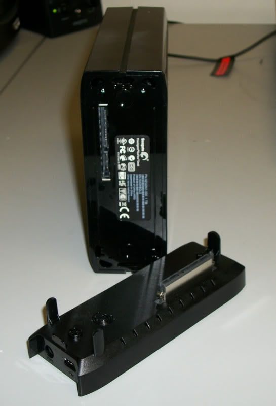

Tripredacus Posted May 4, 2011 Posted May 4, 2011 I wanted to post some photo references but I had to wait until our GoFlex drives came back from other locations. Here is a picture of the drive with the base removed:
