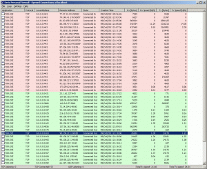

herbalist Posted May 29, 2011 Author Posted May 29, 2011 I've reached a point where I'm unsure how to proceed. Tor and Vidalia run quite well for as long as I let them. At one point, I had problems with the Tor executable using 100% of the processor. Disabling KernelEX for the Tor executable seems to have solved it. Vidalia on the other hand, needs KernelEX. I think the 100% processor usage was responsible for my system clock losing time. Since Tor requires accurate system time, I've left AnalogX's Atomic Time Sync running and have it set to synchronize every 2 hours. So far, so good. According to Shields Up and Tor's own self tests, both the directory and OR ports are reachable. My firewall (Kerio) shows a highly variable number of both inbound and outbound connections, ranging from none to well over 20. Everything I'm seeing here says Tor is working properly. Tor's test sites show me to be properly anonymized when I browse with it. Although I'm set up to work as a relay and exit node, traffic volumes have been extremely low, and my IP has never shown up in the list of active relays or exit nodes. So far, I can't determine why, especially when both Tor and my firewall are showing it to be connected all over the world. I'm starting to think my system is not being accepted as a valid relay because it's running on 98, but have no idea on how to verify if this is the case. I did try to get some advice and help thru their IRC rooms. As soon as they saw I was using 98, all useful discussion ended. It would be a sad situation if this proves out to be the case. The only way I can think of to determine if this is the case would be to set up a Linux system on this PC, equip it with Tor, configure it in the exact same manner, then compare the results. For me, Linux is like a foreign language. I could probably manage to install one and get Grub figured out. Trying to figure out which one to install gives me a headache. I don't know what the differences are or which ones would be fairly easy to install Tor on. I've never installed anything on Linux, so I'm not sure that I could build a proper Linux with Tor for comparison. I'm open to suggestions on both fronts, determining why my existing Tor setup isn't seeing the traffic and building a properly equipped Linux system for comparison.

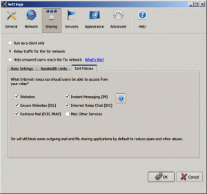

herbalist Posted October 10, 2011 Author Posted October 10, 2011 After concluding that my low traffic levels were due to their not listing my PC as an active relay, I stopped testing running Tor as a relay. After several months and a few Tor version updates, I decided to try running Tor as a relay/exit node again, same settings, new name. After about 30 minutes running, I was listed on their active relay/exit node list for the first time. Because of this, I've seen almost as much traffic in the last 7 hours as I saw the last time in a full week. Several times Tor had 50 or more connections made, both in and out. Other than a couple of version updates to Tor (presently using 2.2.32), not much has changed on my end. Same basic PC and settings. I don't know what changed, but assuming it continues, it's finally giving me a change to test how well an upgraded 98 unit will serve as a Tor relay under a real load and how long it will hold up.

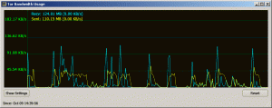

herbalist Posted October 12, 2011 Author Posted October 12, 2011 Some observations after running as a relay/exit node for almost 3 days. Tor has handled 2.5GB of combined inbound and outbound traffic. System and GDI resources have dropped slightly, still over 66%. Processor usage stays low except for when Vidalia is updating the server listings, at which time it's 100%. My system clock loses time when this happens. Since Tor requires accurate system time, I had set Atomic Time Sync to update the clock. Originally the interval was daily but the time loss events are becoming more common and I've repeatedly shortened the synchronize interval, which is now at every 15 minutes. According to Memload, the combined memory load for Tor and Vidalia is just under 30MB. So far, my system has not used the swap file and still has 222MB available of physical memory available out of a reported total of 917MB. This number seems to be slowly dropping, both as reported by Memload and by the system properties screen. My system normally reports 922MB total. I have no explanation for this drop. Memload also reports a substantial increase in memory usage by kernel32.dll. Normally the memory usage for kernel32.dll iis between 400 and 750k. It is now at 8.8MB. I'm not certain that this is due to the Tor/Vidalia load or if SocksCap is causing a problem. According to the properties screen, I'm using version 4.10.2226. It's MD5 is d8fc316196045f3cf4c348bd61fc4540 Are there any known memory leaks or other problems associated with this version? Is there a way to determine why kernel32.dll is using so much more memory than normal? Right now, I'm seeing graphics errors with the browsers (SeaMonkey and K-Meleon), mixed up page elements, desktop items visible thru the browser window, and parts of the page not rendered at all. I'm suspecting a crash is close at hand. I just hate to shut Tor down and reboot since this is the only time my PC has been listed as a valid and active relay.
herbalist Posted October 14, 2011 Author Posted October 14, 2011 The last Tor test has been cut short, not by 98 crashing but by a power failure here. The increased memory usage by kernel32.dll does appear to be caused by SocksCap. After I shut it off, the memory load for kernel32.dll dropped to 2.6MB. The browser graphics improved some but did not get back to normal. The browser wouldn't render properly at full screen. Overall, I was pleasantly surprised by 98s performance. It had handled nearly 4GB of traffic without any problems. I had to reduce the bandwidth settings for Tor as it consumed all of my DSL bandwidth at times and was interfering with the phone service's ability to function. I'm going to change some Kex settings for SocksCap and Vidalia, then start the test again. Hopefully I'll get listed as a valid relay again so I can get the traffic load.
herbalist Posted October 29, 2011 Author Posted October 29, 2011 It seems that every time I try to get a long test run going, Tor updates and I have to choose between running an old version or starting the test over, but this time it's necessary to update. Tor has recently patched a vulnerability that allows an attacker to deanonymize users. More info here. The present stable Tor/Vidalia bundle is version 0.2.2.34-0.2.15, available here. The Vidalia bundle remains compatible with Kex modified 98 systems. I ran the installer with the default Kex settings. Vidalia works with Kex on the default setting. On my PC, the Tor executable seems to work best with Kex disabled. Thankfully, the Tor network has been consistently accepting my system as a valid relay which greatly increases the traffic volume and allows me to test 98 under load. I'm running Tor as a somewhat limited exit node.I had to reduce the bandwidth settings for Tor 24 KB/s average and 32 KB/s maximum due to my low capacity DSL service, which is also my phone service via a separate VOIP modem. When the settings were higher, the bandwidth Tor consumed prevented me from receiving incoming calls. At these settings, both seem to work properly. I haven't changed anything with the old PC I'm using for Smoothwall. I don't have enough network cards to equip another PC for Smoothwall. Switching would require removing the cards from the existing unit, building the next one, then installing,testing and configuring Smoothwall. This would take down both my phone and internet service for an extended period. As far as I've been able to determine, it is not a limiting factor in my home networks performance.The registry changes mentioned in post 5 are still in place. In the torrc config file, I've kept the address entry and removed the KeepAlive entry as it doesn't seem necessary. I can confirm that SocksCap was responsible for the increasing memory usage by kernel32.dll and has also been responsible for a few system lockups. As time permits and as much as I can without shutting down the relay, I'll explore using different Kex settings for the SocksCap executables and into alternatives to using it. SeaMonkey itself is able to connect to Tor via socks but Proxomitron is not. I'm not convinced that SeaMonkey itself (with or without extensions) can be configured not to leak identifiable and trackable data without having Proxomitron filtering the content. Privoxy is a potential alternative to Proxomitron, and it is socks compatible but I'm not familiar with its filtering abilities and limitations. Another possibility would be to use Privoxy strictly for socks compatibility, using it as a substitute for SocksCap, eg SeaMonkey>Proxomitron>Privoxy>Tor. This would require very specific firewall rules and proxy settings in order to prevent javascript, java, flash, etc from bypassing the filtering and revealing your true IP and location. For most users, this isn't that big of a deal, depending on your usage, but in some countries (oppressive regimes) leaking your real IP could literally be a death sentence.
herbalist Posted November 2, 2011 Author Posted November 2, 2011 (edited) A quick update. I've reached a bit of a dilemma regarding which way to go with the testing. This has become at least 3 separate but related tests.1, Can 98 effectively serve as a Tor relay, for how long, and under what loads? As a client, there's no problems running Tor on 98. 2, Can Vidalia be made to run stable on 98 for an extended period? 3, Can SocksCap be made stable on 98 for an extended period? If not, what alternatives can replace it? Tor itself is running very well as an exit node. At times, Kerio has displayed over 100 connections to it with the average number being around 40-50. According to TorStatus, it has reached the 4 day mark. At present, this is the only relay or exit node running Windows 98 listed there. That in itself is a tribute to all of those who worked on all the unofficial upgrade projects. Vidalia is proving to be another matter. Starting last night, Vidalia has been gradually becoming dysfunctional. First, it stopped displaying the network status. This was followed by the traffic graph and the message log failing. Memload and the system resource meter showed the systems had plenty of both available. When Kerio no longer showed any connection between Vidalia and Tor, I terminated Vidalia via SSM. The graphics errors I described in the Oct 12 post, were beginning to appear again, but disappeared after I'd terminated Vidalia. Kex for Vidalia was set to default, which seemed to work good for the previous version. The default setting for Vidalia was to automatically generate a random password when it authenticates itself to Tor. Unfortunately, if Vidalia crashes or gets shut down and Tor continues to run, Vidalia is not able to reconnect to it when restarted. For all further testing, I'll assign a static password to avoid this problem. At this moment, Tor is running and relaying traffic, but I have no ability to monitor its activity. Tor does not actually require Vidalia in order to work and will continue to function according to the torrc config file. The Tor "expert bundle" doesn't include it, but it is a very useful and handy interface. Any further testing of Vidalia would require me to terminate and restart Tor. Without Vidalia, I have no way to alert the other relays that my exit node would be shut down. For the present, I'm going to continue testing the ability of 98 to serve as a Tor relay until one or the other fails. Without Vidalia, I won't be able to get accurate traffic volume figures, but I can get a good indication from TorStatus and from Kerio's status screen. If/when one or the other fails, I will resume testing Vidalia and SocksCap with different Kex settings (and a fixed Vidalia password so I can restart it if needed). Edited November 2, 2011 by herbalist
