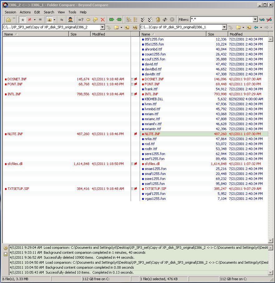

zioni Posted April 1, 2011 Author Posted April 1, 2011 Super!I have followed all of the steps from your tutorial part 1 up to min 11.43 but from some reason I do not see hive.inf at all, only nlite.inf Is hives.inf must be there, or it is there only for your specific operation?Thanks.
Guest Posted April 1, 2011 Posted April 1, 2011 That may be because there are no registry changes other than what may be in nlite.inf.Highlight both sides of nlite.inf, right click it and click open. Press the = / button if not already activated and post a screenshot of the differences. Also I find it weird that all the font show up as needed. Can you also check txtsetup.sif and dosnet.inf and see if it shows those files as a difference.
Guest Posted April 1, 2011 Posted April 1, 2011 I just noticed something on your screenshot. intl.inf is a much bigger size. After looking at my intl.inf it appears that's where languages are stored. Copy intl.inf from i386_1 and place it in %windir%\inf. See if that doesn't bring the language back.
