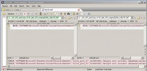

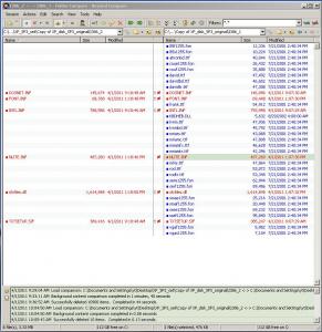

  4. sorry about that, here it is. I also saw your note in regards to the intl, I have swap the 2 files, but nothing have changed.
  5. Just a note here, I am trying to recover both a missing language (Hebrew) and keyboard (Hebrew) Here are the 2 screenshots: Thanks.
