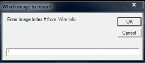

I modified the Inputbox
Enter Image Index # from .Wim Info
You can click Cancel in those boxes and then close cmd window no problem

On second thoughts input box is better if some one was using an AIO there would be a lot more indexes :)
Made a re-write (closes properly on input box cancel, avoids second message box/switch pop up, and cmd /c kills the cmd window afterwords), overall it seems much cleaner. When an input box is canceled it returns a null value, now that I know, this snip checks for that and exits. Else it runs the command without having to go into the second pop-up window. If the CMD /C kills the command window before it's done mounting try CMD /K (that might have been why I used it in the first place for DISM)
