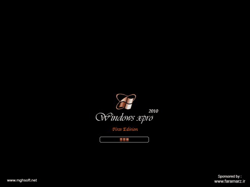

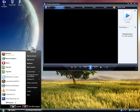

Here's some screenshots :
post-167727-0-95660200-1293965451_thumb.
post-167727-0-85970300-1293965259_thumb.
post-167727-0-93540100-1293965292_thumb.
post-167727-0-53203900-1293965307_thumb.
post-167727-0-62081900-1293965322_thumb.
post-167727-0-13557200-1293965462_thumb.
