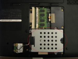

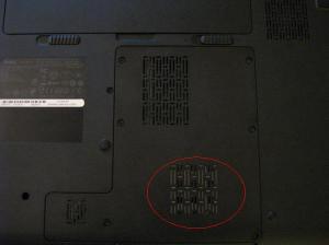

Messerschmitt Posted December 10, 2010 Author Posted December 10, 2010 (edited) Thank you for all your help and support.I will continue monitoring it with NHC and quietHDD since as you said, they are 2 programs that can continue keeping the APM after boot/suspend, etc. I might try with only 1 installed at a time. There COULD be a possibility that the faint clicks I heard were normal HDD clicks? For the parking click, how often it's suppose to happen? Every few minutes, or once every hr or so while doing word processing type of stuff (coding in notepad, etc)?As for the temperature, even tho this laptop is only a few weeks old, I don't think Dell could do anything to elevate the high temperature of the HDD if I send it for warranty, unless there are other drives that run cooler. I attached some pics, and the first picture is the spot that I noticed is the most hot, vs other spots on the back which are not nearly as hot. After opening it, sure enough, that's where the HDD is sitting. It's all packed tight in there, and I don't think there's any room on the other side since that's where the trackpad is. I did noticed the trackpad and surrounding is getting the warmest when I use the laptop.Would it be correct to assume that any other HDD brands like WD would also get hot in that tight space? Unfortunately this is my first laptop, and I don't have any other 2.5" HDD's to test. And by how all tight everything is in there, I think I would be a bit afraid to try take out the HDD. Edited December 10, 2010 by Messerschmitt
GrofLuigi Posted December 10, 2010 Posted December 10, 2010 (edited) First of all, I don't think that your HDD temp is too high. But I'm by no means an expert, so you're welcome to seek second opinion. All laptops get hot, some more, some less. Often, warm exterior is a good sign - it means it's transferring heat properly from the interior. The biggest danger for a laptop is if the paths of air get clogged, and that could happen very easy. What I often do is just raise the laptop some more then its legs allow, with some small objects - bottle caps, pencil erasers etc. There are also many types of "laptop coolers" (stands with fans) to be bought. Working with any laptop on a "fluffy" cloth (example - blanket or tablecloth) for a longer period of time is a big no-no.From your pictures, everything seems fine. The hot spot is a vent and that's where the heat is coming out. The point when I'd start to worry about overheating would be when:1. The computer is shutting down, bluescreening or throwing many errors (but I would check for viruses and/or OS errors first)2. Any area of the laptop is so hot it's uncomfortable to touch - meaning, no matter how much you force yourself to leave your hand on it, after some (short) time you feel you can't stand it any more.I think any other "general" (mass market) brand of HDD would behave similarly, unless it's some specialized solution or SSD, but that's expensive.Again, I repeat, in my opinion, there's nothing to worry about the heat, especially if the laptop is that new.About the clicking: on those laptops I experienced clicking, it was one click every 1-3 minutes. I don't think the clicks are "normal HDD noise" - if we exclude the two cases: thermal recalibration and idle head parking, it should't be happening. I don't know how to determine if the former is happening, and maybe you still haven't eliminated the latter. In any case, I want to reassure you again, both cases don't mean there's anything wrong with the drive, they are just an annoyance.GL Edited December 10, 2010 by GrofLuigi
