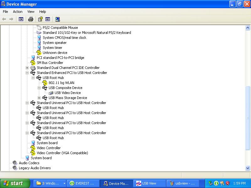

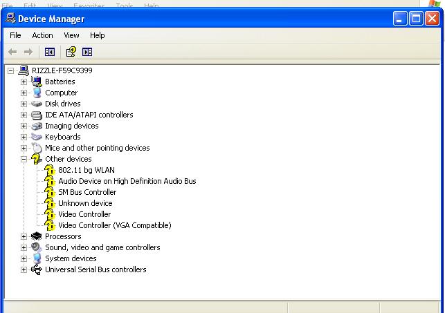

How does device manager list this devices?
post-308046-001747100 1288367110_thumb.j

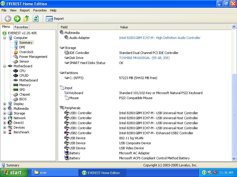

Also, here are the devices listed in Everest, a program i used to get some specs from the netbook. This is the one thats confusing me...
post-308046-045092600 1288367225_thumb.j

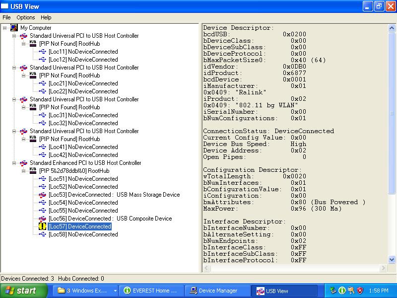

Can you try running USBview or SIV:
http://www.boot-land.net/forums/index.php?showtopic=12845
and post their screenshots?
(from the everest screenshot it seems like more things than usual are connected to the USB bus)

Here is a screen from USBView....
post-308046-015097400 1288375639_thumb.j
and Device Manager, List by Connection...
post-308046-042517500 1288375699_thumb.j

Success! Found a compatible driver after using SIV to identify the vendor for the Wireless adapter (Micro Star International). Thanks so much for the help jaclaz! :thumbup
