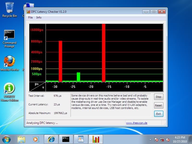

Alright, my problem is high latency as you probably have guessed. I had just recently installed Windows 7 Professional on this computer. I was getting sound drop outs in game (I listen to music while playing games) So I found out about DPC Latency Checker. I downloaded it & sure enough I was getting very high latency.
A few green bars then it would spike off the charts. Now, I have just reinstalled Windows after searching for hours for a solution. however, my high latency problem still exists. I do not have a screen shot of the DPC latency checker. I did 2 checks with DPC latency checker. The first revealed that ndis.sys was the cause of my high latency.

Back. I have included a screen shot of the DPC Latency Checker below. I don't know if the first red bar is because I first opened the checker or what. Usually the bars go off the chart as with the second one.
Here is a screen shot of the Xperf report.
It seems ataport.SYS is the cause of high latency when the on board LAN is disabled. Note, at this point in time, I don't have hardly anything enabled. On board sound is disabled, all my USB ports are disabled, just to narrow down the trouble maker.
My hard drivers are IDE so, I can't exactly get rid of them. However, would this be an outdated chipset driver issue? Thanks for your help thus far.
