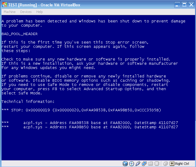

skybox Posted October 19, 2010 Author Posted October 19, 2010 HelloI have successfully created the ISO with the ICH8 Sata driver.I tested the ISO in VirtualBox and ran into problem:When use the default Storage option in VB to set the IDE Primary Master and IDE Secondary Master, the ISO is able to run until the point when it was about to let user select parition and format. It BSOD with acpi.sys error message. (see attachment)However, when Sata Controller is added to the Storage, it can move beyond that point.I am running VB on a P3 PC and I know the original CD would work with the default Storage option selected.Please point out to me where I went wrong. Thank you.
johnhc Posted October 19, 2010 Posted October 19, 2010 HelloI have successfully created the ISO with the ICH8 Sata driver.I tested the ISO in VirtualBox and ran into problem:When use the default Storage option in VB to set the IDE Primary Master and IDE Secondary Master, the ISO is able to run until the point when it was about to let user select parition and format. It BSOD with acpi.sys error message. (see attachment)However, when Sata Controller is added to the Storage, it can move beyond that point.I am running VB on a P3 PC and I know the original CD would work with the default Storage option selected.Please point out to me where I went wrong. Thank you.skybox, without your Last Session.ini, as requested in BOLD RED letters above, we have little chance of guessing. IF VB is anything like VMware Player (that I use) it does not use your drivers but has its own set of virtual drivers. Enjoy, John.

johnhc Posted October 20, 2010 Posted October 20, 2010 HelloI am sorry as I thought the error screen capture would be enough. The ini file is now attached.Thank you once more.skybox, thanks for the Last Session. Yours is very simple and I see nothing that could cause your BSOD. I do agree with Sp0iLedBrAt that you should try Fernando 1's driver. He is the driver expert here. Using all those various versions of the driver is asking for trouble. If all the driver files (xxx.sys) have the same name, then only the last one is used. If it is not the corrected one then your install (on HW) will not work. These driver issues are not your VB problem, however, since VB will use it own virtual drivers. Did you run nLite more than once against the same source? You should always start with a fresh copy of your CD files/folder and run nLite only once doing all your work. I am curious why you did not integrate SP3? Where did your source come from and what type is it - OEM, Retail, Recovery or ...? You might try removing all your drivers (starting with a fresh source copy) and installing on VB. Please let us know what your learn. Enjoy, John.
skybox Posted October 22, 2010 Author Posted October 22, 2010 (edited) skybox, thanks for the Last Session. Yours is very simple and I see nothing that could cause your BSOD. I do agree with Sp0iLedBrAt that you should try Fernando 1's driver. He is the driver expert here. Using all those various versions of the driver is asking for trouble. If all the driver files (xxx.sys) have the same name, then only the last one is used. If it is not the corrected one then your install (on HW) will not work. These driver issues are not your VB problem, however, since VB will use it own virtual drivers. Did you run nLite more than once against the same source? You should always start with a fresh copy of your CD files/folder and run nLite only once doing all your work. I am curious why you did not integrate SP3? Where did your source come from and what type is it - OEM, Retail, Recovery or ...? You might try removing all your drivers (starting with a fresh source copy) and installing on VB. Please let us know what your learn. Enjoy, John.Hello"The drivers you're using are the culprits" look for this line here: http://forums.virtualbox.org/viewtopic.php?f=2&t=29628&p=133692&hilit=ich8#p133692that was the pointer 'cos things worked when I tried Intel Storage Manager 7.8 driver.Back to nlitemodded 32-bit ICH6-10 ver 9.6.0.1014: VB-IDE, VB-Sata, VMPlayer -> BSODmodded 32-bit 8.9.6.1002: VB-IDE, VB-Sata, VMPlayer -> OKSo, driver from certain version won't work.The next thing to do is to install the nlited cd to the real physical ICH8 system.Lastly, thank you to all who gave pointers. Edited October 22, 2010 by skybox
skybox Posted October 23, 2010 Author Posted October 23, 2010 Try Intel (RST) 10.0.0.1046 WHQL too.Tested using 1 driver from the mentioned package and did not BSOD.I downloaded the package from station-driver.com 'cos unable to find it at Intel.Regards.
cdob Posted October 26, 2010 Posted October 26, 2010 did not BSOD.At VMware and different real hardware: iastor.sys 9.x BSOD ocassionally at IDE mode.iastor.sys 8.x and 10.x does work fine.Overall:Avoid iastor.sys 9.x at dual usage XP installations.Use iastor.sys 8.x or 10.x
