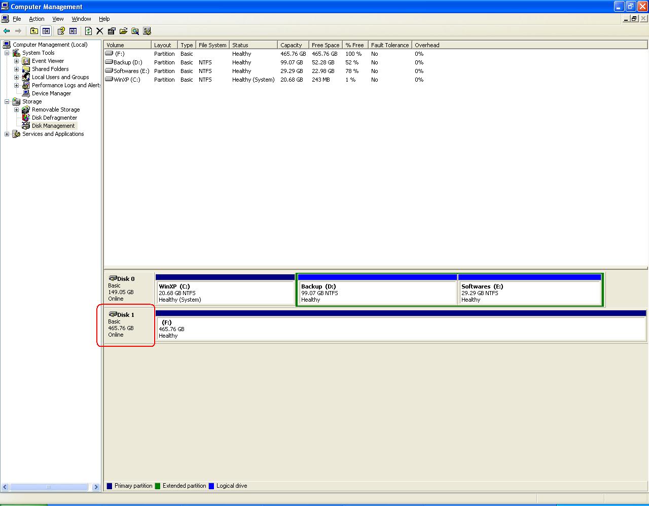

Hi Thanks for quick response
I am adding few screen prints which shows the Disk Management Status & HDD Status Via Crystal Disk.
(One interesting thing I observed While ScanDisk was started at first time... I can see the Volume Label.. but in Disk Manager I cant see it.. But TestDisk shows volume Label..)

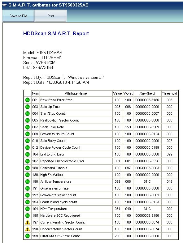

I have tried the HDDScan tool also.. Please find the following attached results
Also I am attaching DDRescue errors screen print as requested by you.
(Please note -I am worked only on selected area with DDRescue.. it is reflected in screen print)

What does Victoria show?
http://www.benchmarkhq.ru/english.html?/be_hdd.html
From the looks of what you posted it seems like you've managed to kill the disk allright.:ph34r:
Most probably it is still recoverable, but you will need software and hardware that is outside the reach of a hobbyist. :(
I am talking of products like PC-3000 or HD Doctor, thingies going in the range of a few thousands US$.
jaclaz
