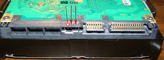

Followed directions as stated.. I am still getting "unable to open com4. Check port settings"..HArd drive is not attached to PCB..insert a card stock between connections and only 3 screws on the pcb and HDD
Now getting the echo..
In that case we're almost there! :thumbup
First disconnect the power to the shifter!
Remove the PCB from the harddrive and connect:
  • The TX of the shifter to the RX of the harddrive
  • The RX of the shifter to the TX of the harddrive
  • The GND of the shifter to the GND of the harddrive
    (Be extra carefull not letting the wires touch each other)
Next:
  • Apply power to the shifter
  • Open a connection with HyperTerminal (using the settings from my earlier post)
  • Apply power to the PCB (remember: the harddrive itself is not attached now)
  • Press the CONTROL and Z-button at the same time
Now tell me what you see (you can copy and paste the text you see in HyperTerminal
in your next reply between [ CODE ]-tags for clarity).
Greetz,
Peter.
That's a problem with the convertor itself and has nothing to do with your harddrive.
You probably removed the shifter from the USB-connector while a connection was still
active in HyperTerminal. :whistle:
The easiest way to resolve this problem is to give your PC a cold boot (turn it off,
then on again).
After that, just start from the top (connect it to harddrive PCB and apply power).
BTW: Did you manage to get a 3.3V supply; either from an orange wire from a SATA
power connector or using two 1.5V (or one 3V) battery?
Greetz,
Peter.
The Orange and black wires did the magic..my hardrive is restored. Thank you and all who have put in the hard work to find a solution to this problem...
