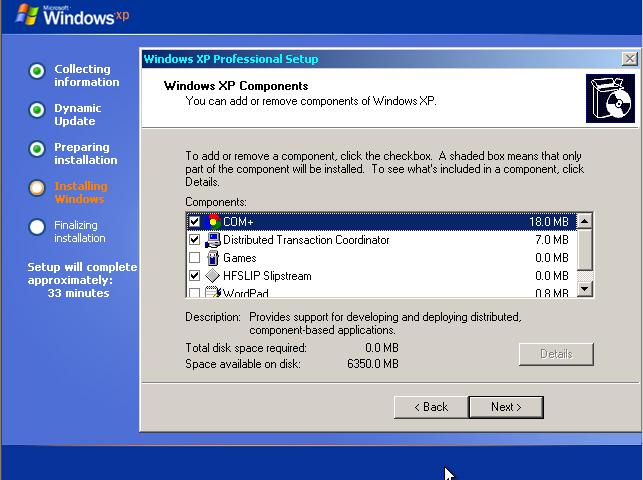

fdv Posted May 13, 2010 Posted May 13, 2010 (edited) Somehow, I triggered it.Here's a screenshot from my VM during setup.I have done so many installs that I can't remember -- this isn't supposed to happen, right?It does with my current fileset but I don't know what I changed to trigger it. I have a suspicion but I am not positive.edit: better screenshot Edited May 14, 2010 by fdv
cluberti Posted May 13, 2010 Posted May 13, 2010 What sysocmgr calls are being made when this happens? Seems like something during setup called sysocmgr.exe against a custom file, although it's been while since I've tried it as well so it's a little hazy. Does this happen during GUI-mode setup, or on first login?
fdv Posted May 13, 2010 Author Posted May 13, 2010 (edited) Here's the answer.I will post the instructions tomorrow when I am at work and have my files.Basically, my thought process:Windows NT 4 populated the Registry with a hive file which I studied endlessly using REGEDT32. Years later, I am playing with Windows 2000 / XP / 2003 HIVE files (which I have begged and pleaded for people to experiment with FOR YEARS all to no avail -- come on, folks, if I'm the ONLY ONE doing this, nifty little discoveries take forever to find).I noted an odd discrepancy just the other day -- the NT4 registry data did not have any settings saying "this is a Windows installation." The NT 5.x HIVE files -do-, however, as does IE.INF. They all have markers saying, essentially, "the Windows setup process is underway."I decided to move the registry values that said this out of the HIVE files to somewhere else. My logic was that Windows setup will no longer be "aware" that that's what's happening. Now, my HIVE files populate the registry the NT 4 "classic" way and there is nothing to tell Windows that anything unusual (like an OS installation) is happening.Without these "setup is happening right now!" values in the registry when the SYSOC file is parsed, the Add/Remove options dialog pops up. Right after you are asked your name and organization and right before networking is installed.I will post the specific values tomorrow. The answer lies in HIVESYS. Edited May 14, 2010 by fdv
fdv Posted May 14, 2010 Author Posted May 14, 2010 (edited) STEP 1Open SYSOC.INF (after expanding it obviously)Comment out:NtComponents=ntoc.dll,NtOcSetupProc,,4To keep the byte count the same for LAYOUT, replace the H with semicolons:;tComponents=ntoc.dll,NtOcSetupProc,,4Re-compress it using MAKECAB. Don't forget to delete the expanded INF so that there is only the one SYSOC.IN_ file.STEP 2Open HIVESYS.INFscroll toHKLM,"SYSTEM\Setup","SetupType",0x00010003,1HKLM,"SYSTEM\Setup","SystemSetupInProgress",0x00010003,1Comment these lines out. To keep the byte count the same for LAYOUT, replace the H with semicolons:;KLM,"SYSTEM\Setup","SetupType",0x00010003,1;KLM,"SYSTEM\Setup","SystemSetupInProgress",0x00010003,1I know nLite is popular, but this is a way to keep options rather than destroy them forever.It blows me away that there is absolutely zero interest in this. Edited May 14, 2010 by fdv

fdv Posted May 14, 2010 Author Posted May 14, 2010 "There isn't. Maybe others aren't at msfn 24/7." Okay Brabant, you got me thereI tried this two-step on a totally clean XP.It works (so one does not have to use my fileset) but it would appear that checking / unchecking items did not actually work once the OS completed installation. So maybe it's just cosmetic, which is hard to believe but maybe.So I need some technical help. I have been fiddling with the HIVE files for a week now and I'm out of ideas right at the moment. At that point above in the setup, SHIFT + F10 brings up a CMD box which I then usually use to start REGMON and FILEMON from sysinternals via the command line. I save the logs to the desktop (which exists even prior to installation being finished) and then do whatever I'm going to do, and the REGMON and FILEMON "record" what Windows is doing during the install. I then wait until Windows is just about done and I re-save both, close them and then I can view the logs once Windows is installed. This is how I examine what really happens during an install.All sorts of things can be done including launching REGEDIT to tweak reg values in real time (only take effect on reboot) and many other things. Including, of course, playing Pinball during setup by CD'ing to its directory and typing pinball.exe. Anyway. You get the idea.So, this is a public cry for assistance to test this, and if it is only cosmetic, to see how to get it working!
