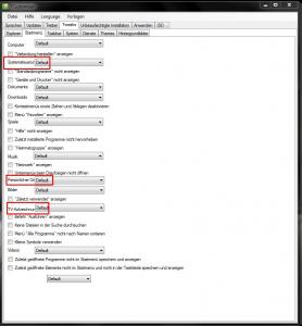

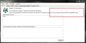

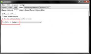

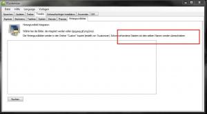

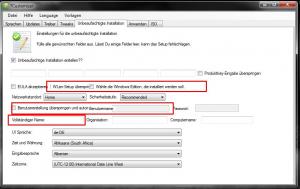

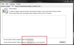

Hi blue,
here are the german languages for 7customizer: Download Deutsch.lng
I hope you can install the Deutsch.lng directly ti 7customizer.
The Win-Lite.de Forum will be updated the languages, when a new version appears.
Also we have the same problems like grabben HERE.
Not enough room for the german text in the lines and also on the Buttons.
Here are the Screens:
I hope you can fix this in the next versions.
Thanks for your work :thumbup

Hi blue,
beatmaster
Regarding the last attachment, i already notified him and he will have it fixed for next version :)
