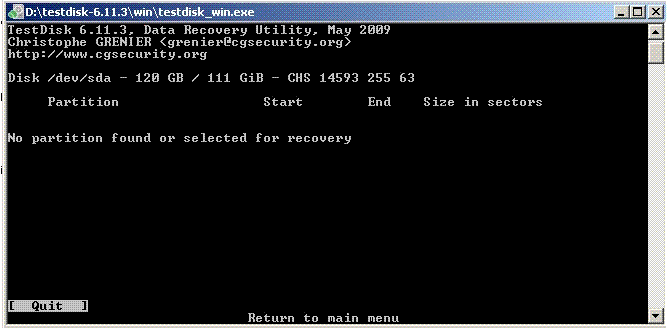

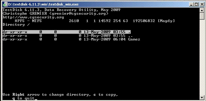

ahmad2080 Posted September 23, 2009 Author Posted September 23, 2009 (edited) Thanks for your replies...First I've tried TESTDISK ... The first search found the C partition only. Then the "Deeper Search" found the following:Here are the Pics: This is what's in The first volume:This is what's in The second volume:This is what's in The third volume that we need to recover:After pressing ENTER it says:TESTDISK found the D partition (Magdy volume) but didn't find all of the folders in it (Only the Gamez folder was found).NOTE: The size of the hard disk is 120 GB.....After using Norton Ghost total space became 111 GB !!!!! About Recuva...It's still in progress.....I'll post the results as soon as it finishes..EDIT: After Recuva finished, It found SOME files that were in the D partition but indicates it's path as C:\?\Should I proceed and recover those files? Or it's possible to recover the whole partition? Edited September 23, 2009 by ahmad2080
jaclaz Posted September 23, 2009 Posted September 23, 2009 Translation of Testdisk screenshots (apparently)Before "overghosting" there was:a partition on cylinders 0÷2609, sectors 41,929,587x512=21,467,948,544 bytes (around 20 Gb)a partition on cylinders 2610÷14592, sectors 192,506,832x512=98,563,497,984 (around 100 Gb)The image was "superimposed" spanning the whole disk, thus creating a new partition:a partition on cylinders 0÷1492, sectors 234,436,482x512=120,031,478,784 (around 120 Gb)The "old" partitioning info was not overwritten, but it is possible that other filesystem structure partially were.Yes, file oriented data recovery is needed at this point, depending on the fragmentation grade of the old partitioning (and size of the single files), results may vary from very good to very poor.jaclaz
