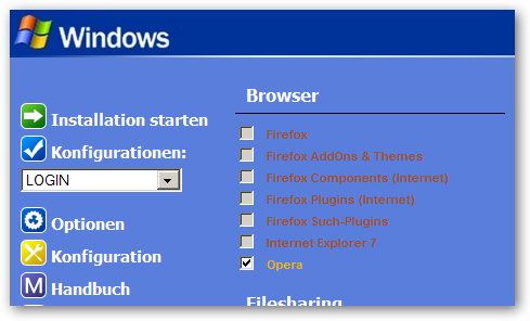

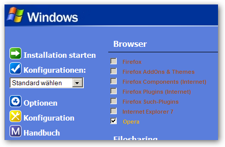

Then i start again from cmd line "wpi.hta check=LOGIN timer=4"
The same result, which I describe already. WPI starts with the timer, but the configuration is ignored.
When i want to run wpi.hta with cmd-line-args, I think, it is essential, that there is no line with "CheckOnLoad='...'" in the config.js
So i change one line in the configwizard.js:
tf.WriteLine("//CheckOnLoad='" + document.getElementById("CheckOnLoad").value + "';");
Restart with "wpi.hta check=LOGIN timer=4"
WPI start with the LOGIN configuration, but shown is configuration: default (in german: Standard)
