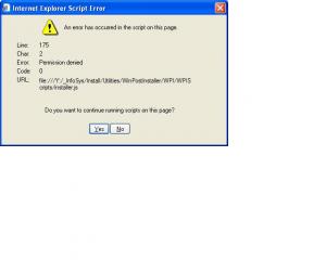

When attempting to run WPI 7.7.0 on Windows XP 32-bit, I keep getting an Internet Explorer Script error "Permission Denied / Line 172 / Char 2 / Code 0 / URL file:///Y:/_InfoSys/Install/Utilities/WinPostInstaller/WPI/WPIScripts/installer.js"
This only happens after running the WPI program and installing any single or multiple selections of items first. I am unzipping the program from the download and adding the config.js, useroptions.js, and windowsoptions.js files to the WPI Scripts Folder. I have tried recreating new scripts by going through and recreating my entire install list and groups. I have not edited the code manually.

I am running from the desktop manually after windows is installed and after I have joined our domain and mapped the network drives.
If I remove the WPI Directory entirely and extract the files from the download, I can get it to run once without any errors. If I launch WPI after that and try to install one of my programs, I get the error message.
The installer does not open and the WPI Window is blank and will not close unless I use ALT+F4.
I should also note that I am using IE8 as that gets installed during my RunOnceEx programs.
