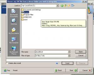

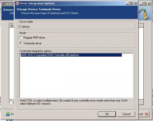

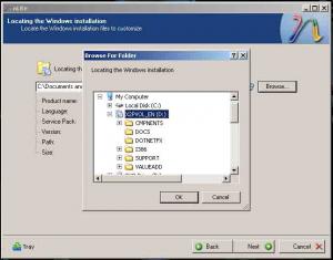

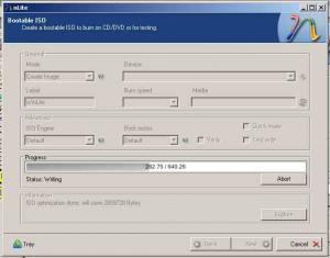

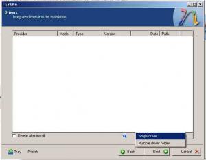

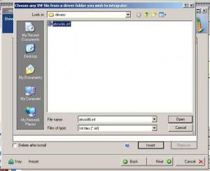

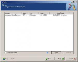

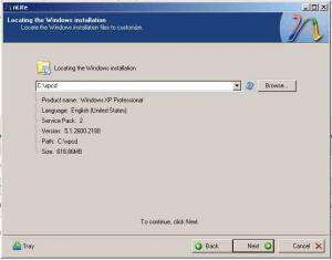

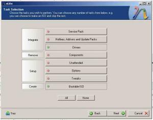

Following Fernando 1's advice, I made 3 new folders on my root C:\, drivers, xpcd, and iso. Redownloaded a fresh copy of the 32 bit drivers from post #234 and extracted them into c:\drivers. Put my XP CD into my computer, booted up nLite and had it rip the CD to C:\xpcd. I then went through the process, did not use any old session data, inserted the 32 bit driver into nLite in text mode. Then I made the ISO and burned it to a CD with ImgBurn. Still exact same thing. BSOD 0x0000007E after the first part of the text mode xp setup (After it loads all the drivers with the text on the bottom). I'm sure I'm doing it right I just don't get why it wont work for this computer.
Other things I've tried:

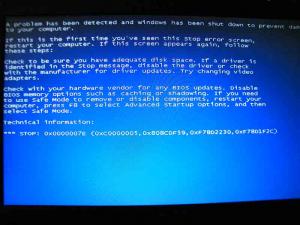

Removing the hard drive from the laptop to eliminate the possibility of a faulty hard drive, and running xp install setup. Still get BSOD 0x0000007E at the same place.
Swapping out the ram with ram from another computer. Same thing, BSOD 0x0000007E at the same place.
Attached screenshots from my latest nLite session and the last session.ini.
/headdesk

@ manticmage:
Thanks for your detailed report.
The Stop: 0x0000007E BSOD is typical for the presence of a wrong textmode driver within the media you are booting off.
Since you have integrageted the correct AMD AHCI driver for Windows XP, I suspect, that the XP CD you have used as source, may be not as clean as you have thought.
Please look into the i386 folder of the XP CD. Is there a file named WINNT.SIF?
If, yes, it is not an original (= untouched) XP CD.
