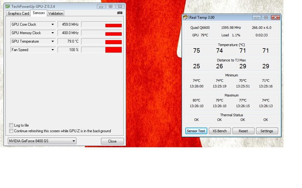

c0nt3nd3r Posted July 5, 2009 Author Posted July 5, 2009 Lag has been happening for a while with my current setup however, recently, whenever I have to restart my pc it beeps 3 times with the 3rd beep being longer than the first two and I have to leave the PC off for a bit. So, I am wondering if something is overheating, but the local PC repair guy told me it could be bad ram or gpu also.Also, before going in-game if I lower my desktop resolution which I just started doing recently I find it helps somewhat with lag and overall gameplay.
Zenskas Posted July 5, 2009 Posted July 5, 2009 (edited) Lag has been happening for a while with my current setup however, recently, whenever I have to restart my pc it beeps 3 times with the 3rd beep being longer than the first two and I have to leave the PC off for a bit. So, I am wondering if something is overheating, but the local PC repair guy told me it could be bad ram or gpu also.Also, before going in-game if I lower my desktop resolution which I just started doing recently I find it helps somewhat with lag and overall gameplay.Not sure about the first problem but if you buy a new GPU and it still happens then that eliminates one thing that is stuffing up and you will not have to change to lower resolutions too! Using a memory testing program like Memtest86+ you can see if its bad RAM. As for heat just use a program like Real Temp to see if the CPU is overheating and something like GPU-Z to see if your GPU is overheating. Edited July 5, 2009 by Zenskas
ripken204 Posted July 5, 2009 Posted July 5, 2009 so its not internet lag, it would either be gpu. cpu, or ram.run taskmanager while playing a game, then when "lag" happens minimize the game and check out what the cpu and ram usage is.Its pretty easy to see where the lag comes from He has a Q6600 CPU with 3GB RAM so thats OK. Look at the specs for his PC. Gaming on a 24inch monitor with an 8400GS??? There you go. Like I said in my first post, a new GPU is needed and if your PSU is only a cheapo low watt model then a new one of those too.which is why i recommended a 4870/4890 in my first post
c0nt3nd3r Posted July 5, 2009 Author Posted July 5, 2009 (edited) Lag has been happening for a while with my current setup however, recently, whenever I have to restart my pc it beeps 3 times with the 3rd beep being longer than the first two and I have to leave the PC off for a bit. So, I am wondering if something is overheating, but the local PC repair guy told me it could be bad ram or gpu also.Also, before going in-game if I lower my desktop resolution which I just started doing recently I find it helps somewhat with lag and overall gameplay.Not sure about the first problem but if you buy a new GPU and it still happens then that eliminates one thing that is stuffing up and you will not have to change to lower resolutions too! Using a memory testing program like Memtest86+ you can see if its bad RAM. As for heat just use a program like Real Temp to see if the CPU is overheating and something like GPU-Z to see if your GPU is overheating.My PC case is inside a cubby hole like area as my desk has a cupboard like area to put my case in underneath the desk. This is probably limiting airflow even though there space on each side of the case.Can the Memtest program be run using a program like MagicDisc or does it have to be burned to a cd? Edited July 5, 2009 by c0nt3nd3r
