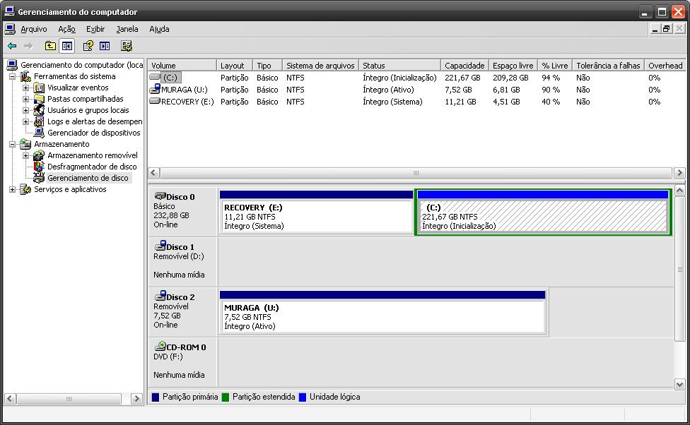

My disks are in this mode:

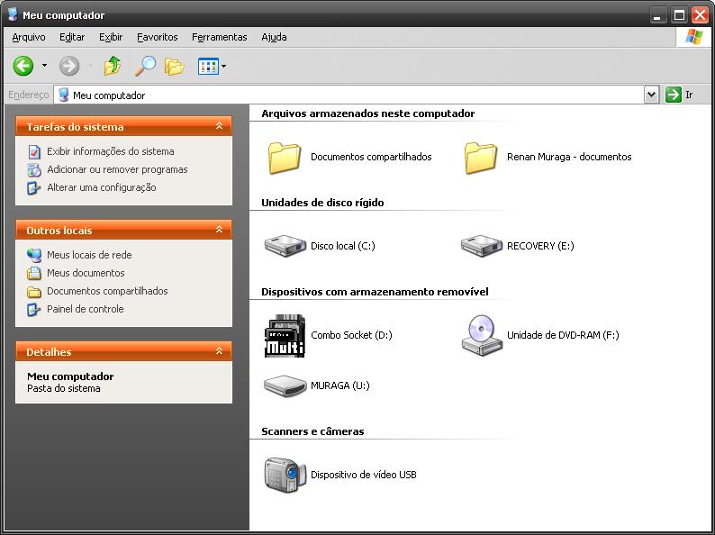

My Computer is this
I have the windows installed on drive C:, the E: is a vista recovery files who cames with notebook. The D: I think is from the installation of winsetupfromusb. The U: is my pen drive, from where I boot.
In secondpart (from usb boot) the windows say my drive C: (listed here) is the Partition 2. All times I boot from pen drive, they go to the second part installation (they not go to the "third" part...)

1) You need to disable/disconnect USB card reader if possible during setup
2) The second partition on the hard disk must be PRIMARY, not logical inside extended, and set active in advance. Then boot files will be placed on the second partition, where your windows will be. You can use PartedMagic to delete the second partition, make a new one as primary type and set it active. Then you can reinstall. Backup any important data you have.
In this case you should be using again "Second part of XP Professional setup from hd 0 part 2".
I guess Setup deleted grub4dos bootsector, that's why you don't have first part now. Quick workaround is to add this line at the bottom of boot.ini on the USB stick:
c:\grldr="Start First part of setup"
I guess you copied boot.ini to C: manually, didn't you? Are there NTLDR and NTDETECT.COM too?
