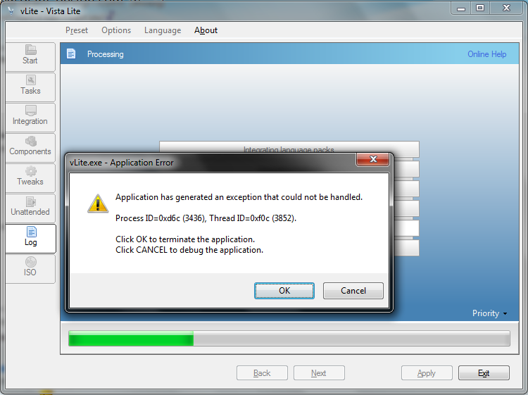

Exception that can't be handled O.O
Look at the picture... Can anyone tell me what's wrong?
Thanks in advance!
I'd run a memory check if i was you. Could be some bad ram.
i had a similar error when i had the wrong version of the wim filter installed? make sure you have the wim filter from waik 1.1 not the one from waik 7? :unsure:

At the "Clean Part" (After Removing components)
@Hegel
There's nothing wrong with my ram, checked that the first time I got this error...
@dead0
I have the right WAIK, because this WAIK is used earlyer to use vLite, and it worked fine earlyer, so that's not the problem =.=
I don't like this, because I only used this current OS as a temporary one, and now I can't make a new one XD Or I'd have to reinstall Vista again =.=

alternatively, delete vstemp19? (if its there) from your temp directory & start over? :unsure:
what's the temp folder which uses vLite? Make sure, that is not read only and uses a short name. And also disable any running AntiVirus tools while vLite runs.

That folder excists, but it's totally empty, deleted it anyway ^^
@MagicAndre
C:\Users\x\AppData\Local\Temp (Standard folder)
And it's not read-only ^^
I think I've found it allready, I might've put the wrong wimgapi.dll into the vLite folder, I'll try to put another in, and will tell if it fixed later on.
