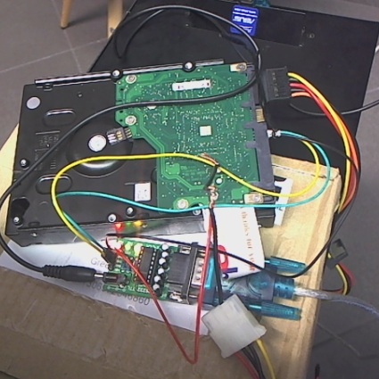

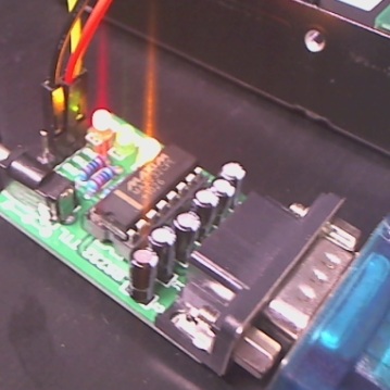

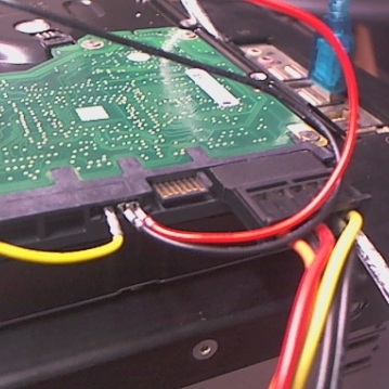

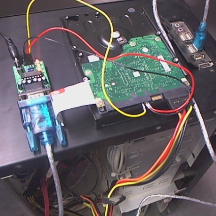

andefined Posted August 25, 2011 Posted August 25, 2011 Hi, i am really confusedi've read this post and also this post i then purchased this converter http://www.ebay.co.uk/itm/260836151037?ssPageName=STRK:MEWNX:IT&_trksid=p3984.m1439.l2649 and this cable http://www.ebay.co.uk/itm/250653067355?ssPageName=STRK:MEWNX:IT&_trksid=p3984.m1439.l2649ny steps:1. connected the cable with the converter2. performed the loopback test succesfully3. connected the tx(hdd) to rx(converter), rx(hdd) to tx(converter), gnd(hdd) to gnd(converter), sata power supply from same pc and added the card on the motor4. waited for the motor to stop5. started hyperterminal or putty (under w7)6. entered the correct values COM3, 38400, 8, 1, N, N and connectd7. when i type Ctrl + z there is no response8. reversed the rx and tx but i get the error with the weird characters9. reversed again but no response10. removed gnd no response11. removed convertor's power supply got the error with the weird characters(weird error)(my setup)any ideas apreciated
jaclaz Posted August 25, 2011 Posted August 25, 2011 Seemingly your GROUND is ineffective. Re-read attentively the Read-me-first and these posts:from #3818 to at least #3834From the pictures you posted seems like the ground from your PC PSU is NOT connected to the ground on the TTL side of the RS232-to-TTL adapter and of course to the ground of the whatever power supply actually powers the adapter itself.Using a BLACK cable for ground make help conforming to the "universal" standard colopuring convention, from the pictures it seems like you are using the Black cable for Tx and the Yellow for ground but this is obviously only an "esthetical" point.Right now you seem like having:PC PSU ground connected to the HD PCB through the SATA power cablePC PSU ground connected to the USB side of the USB-to-RS232 Serial converter through the USB cablePC PSU ground (maybe) connected to the RS232 side of the USB-to-RS232 Serial converter (internally in the USB-to-RS232 converter)PC PSU ground (maybe) connected to the RS232 side of the RS232-to-TTL converter (internally in the USB-to-RS232 converter)RS232-to-TTL power supply ground connected to the RS232-to-TTL converterRS232-to-TTL power supply ground (maybe) connected to the TTL side of the RS232-to-TTL converter (internally in the RS232-to-TTL converter)RS232-to-TTL ground connected to the PCB through the yellow wireAny (maybe) is not good. jaclaz

andefined Posted August 26, 2011 Posted August 26, 2011 Seemingly your GROUND is ineffective. Re-read attentively the Read-me-first and these posts:from #3818 to at least #3834From the pictures you posted seems like the ground from your PC PSU is NOT connected to the ground on the TTL side of the RS232-to-TTL adapter and of course to the ground of the whatever power supply actually powers the adapter itself.Using a BLACK cable for ground make help conforming to the "universal" standard colopuring convention, from the pictures it seems like you are using the Black cable for Tx and the Yellow for ground but this is obviously only an "esthetical" point.Right now you seem like having:PC PSU ground connected to the HD PCB through the SATA power cablePC PSU ground connected to the USB side of the USB-to-RS232 Serial converter through the USB cablePC PSU ground (maybe) connected to the RS232 side of the USB-to-RS232 Serial converter (internally in the USB-to-RS232 converter)PC PSU ground (maybe) connected to the RS232 side of the RS232-to-TTL converter (internally in the USB-to-RS232 converter)RS232-to-TTL power supply ground connected to the RS232-to-TTL converterRS232-to-TTL power supply ground (maybe) connected to the TTL side of the RS232-to-TTL converter (internally in the RS232-to-TTL converter)RS232-to-TTL ground connected to the PCB through the yellow wireAny (maybe) is not good. jaclazthanks for the help,here is a new pic of my setupblue wire tx > rxyellow wire rx > txblack (on hdd) gnd to gnd connected with the red wire psu gndthe power supply comes from a usb, when i try to gnd the - of the power supply i get the weird characters error else i don't get anything.thanks, dimitris
jaclaz Posted August 26, 2011 Posted August 26, 2011 (edited) blue wire tx > rxyellow wire rx > txblack (on hdd) gnd to gnd connected with the red wire psu gndthe power supply comes from a usb, when i try to gnd the - of the power supply i get the weird characters error else i don't get anything.thanks, dimitrisHMMM. You need to make sure that ALL (meaning ALL) 0V or grounds of ALL equipment involved is properly connected together.You need to make sure that TX and RX DO NOT touch between them. (unless you try a loopback test - something that you did not specify - it is as well possible that the adapter is not good)You are supposed to NOT get anything until you press CTRL+Z. (when connected to the HD PCB).From the pictures you posted ALL connections, exception made for the TX/RX ones on the TTL side of the RS232-TTL converter look like badly done/insecure/not proper.Since you have an available Molex connector, get the power (0V and +5V ) from it INSTEAD of the whatever "power supply comes from a usb" to power the RS232to TTL adapter.Are you SURE that you got a 3.3V TTL converter (the page you mention - like most of the other similar ones seem like having been written by a headless chicken) it talks about 5 V logic, then about 3.3V one then about "Built with MAX3223/SP3223 from MAXIM/SIPEX/TI" but the picture is of a MAX232 which AFAIK is 5 V only. Check the actulal IC number on the chip on your adapter.Verify that the Vcc pin gets 3.3 V (and NOT 5 V) if chip is a 3223.Once verified the above do a loopback test.jaclaz Edited August 26, 2011 by jaclaz
