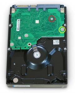

hiro Posted October 11, 2009 Posted October 11, 2009 Hi banjaluka!I am also in trouble with DETSEC error, my disk doesn't spin up after U command.Could you help me where to screw the PCB?I don't know where it was supposed to be connected to head contacts.YES!!!!I did it - thanks God, and all of you kind people around the world posting those messages and your experiences solving this awful problem.God bless you all!!!It was my fault for not having the most recent backup, but having the disk that is less then 1 year old I really didn't think this could have happened.Especially not on this magnitude of thousands of soon-to-be ex-Seagate customers :-(I made it with genuine Nokia CA-42 cable and Windows didn't recognize it until I provided 5V power to the cable from the my computers power supply, and connected hard disk to it. (I though that I broke the cable and almost went for another one.)Another thing that caused some additional gray hair on my head was this DETSEC error after trying to spin it up, like in the commented post:Oh dear... I followed the instructions but I seem to have made things a lot worse. ...I used a piece of card to isolate the heads contact and all seemed fine until the step to spin back up and I got this:F3 2>UError 1009 DETSEC 00006008Spin ErrorElapsed Time 13.550 secsR/W Status 2 R/W Error 84150180mrlondon, I don't know if you have already solved it, but in my case the reason was that I had the card that isolated PCB from the head contacts was mounted for a day or a two (until I've fixed the problem with the cable), and removing the card didn't really provide contact between the two.So what I had to do additionally, was to carefully screw the PCB where it was supposed to be connected to head contacts. It solved the problem - spinning up and the rest of the instructions worked like a charm! Now, I am backing up my data, and as soon as that is finished, I am going back with this hard disk to the shop where I bought it!Thank you all kind people!

banjaluka Posted October 11, 2009 Posted October 11, 2009 Hi banjaluka!I am also in trouble with DETSEC error, my disk doesn't spin up after U command.Could you help me where to screw the PCB?I don't know where it was supposed to be connected to head contacts.Hello hiro,on the attached image, you will see the red marked circle showing the screw that is fixing board to the head contacts. In my case, I had only two screws not fixed (the other one is marked with the yellow circle), since I followed instructions shown on nitrohelix's video you can find on the http://www.youtube.com/watch?v=29FztWJVxbM.As I wrote in previous post, I had the isolating card under the PCB for a few days, and it probably deformed the board little bit, making therefore the contact between the board and the contacts of the head loosen even after removing the card.Actually, to play on the safe card, just be sure that you carefully (!) fixed all the screws after removing the card (before trying to spin-up the hard disk engine with the "U" command).I hope this will solve your problem as well - thanks God, it solved mine.
