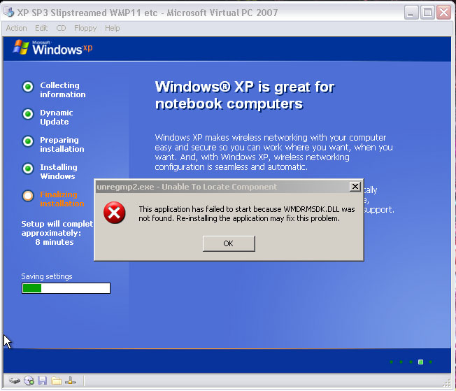

ronny69 Posted August 22, 2008 Author Posted August 22, 2008 (edited) Hi,Well after slipstreaming SP3 first and THEN integrating WMP11 (yes I have always started with a clean XP source), it looks like WMP11 is in fact present after installation is finished but there is no link in the start menu for it or on the desktop. I can start WMP11 from the programs folder though. Also, during the installation process the following error comes up regarding WMP11:Any ideas?I will try this different WMP11 integrator mentioned above and see how that works.Cheers for the advice Edited August 22, 2008 by ronny69
