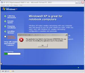

  1. Hi, Well after slipstreaming SP3 first and THEN integrating WMP11 (yes I have always started with a clean XP source), it looks like WMP11 is in fact present after installation is finished but there is no link in the start menu for it or on the desktop. I can start WMP11 from the programs folder though. Also, during the installation process the following error comes up regarding WMP11: Any ideas? I will try this different WMP11 integrator mentioned above and see how that works. Cheers for the advice
